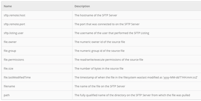

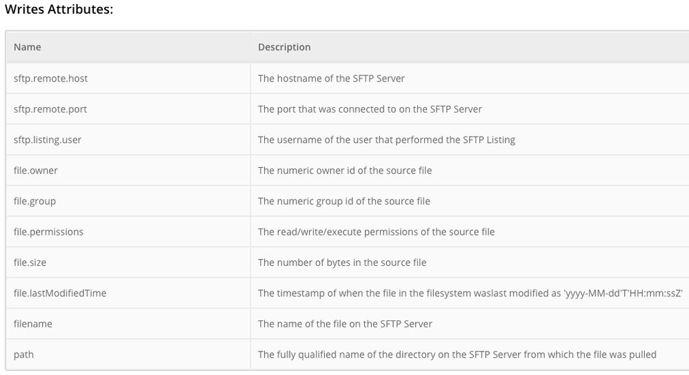

The ListSFTP processor will output a NiFi FlowFile for each file that is listed.  Also those produced FlowFiles will have FlowFile attributes set on them with:
So you might want to list those FlowFiles in the NiFi connection queue an inspect what values were set on these properties.  Are they correct?
These attributes can then be used in the FetchSFTP processor to facilitate the fetching of the content for each FlowFile listed.

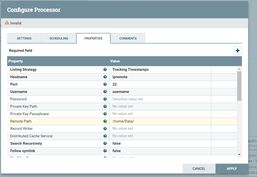

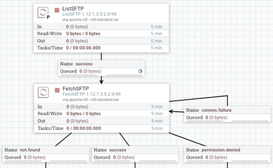

Hi@MattWho, I have a folder of files. Here is the configuration I tried to set up but the problem is on remote filename I tried: remote filename = ${/home/Data/}  remote fiename = /home/Data/, but both do not work.
ListSFTP  settingsListSFTP settingsFetchSFTP settingsFetchSFTP settings
