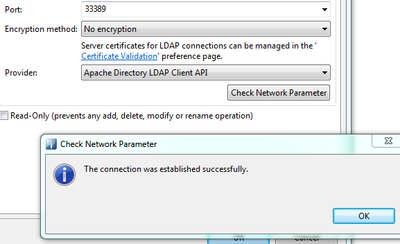

Network settings are fine =>

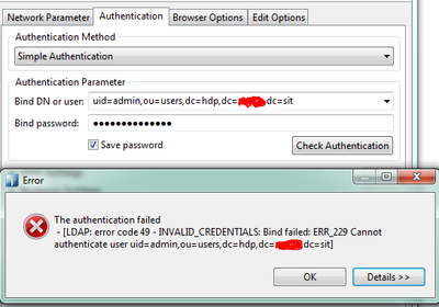

But I got stuck in providing correct bind credentials.....what to provide there ?!?!
I also tried to provide the following bind dn: uid=admin,ou=users,dc=hdp,dc=XYZ,dc=sit , but it fails also, with error
Any hint highly appreciated 😉

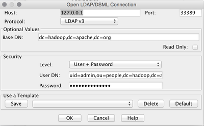

Here is how I connected via JExplorer (If you are using the Sandbox, you need to expose port 33389)

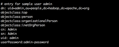

This of course assumes you haven't changed the users.ldif file. I'm guessing you are trying to use your real domain but haven't updated the user.ldif file to reflect that. For reference here is the entry for the admin user in the default demo users.ldif file.
dn: uid=admin,ou=people,dc=hadoop,dc=apache,dc=org
objectclass:top
objectclass:person
objectclass:organizationalPerson
objectclass:inetOrgPerson
cn: Admin
sn: Admin
uid: admin
userPassword:xxxxxxxxxxxxxx

I guess the issue may be caused by the difference of connecting to the LDAP server. In the non-working one I have to create a ssh-tunnel to port 33389 due to firewall issue, whereas in the working cluster there is no firewall in front and I can directly access it. But I have no explanation what exactly can go wrong there, since accessing the port isn't an issue (see screenshot 1)...?!

@Gerd Koenig
Here is your answer:
