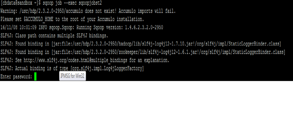

how to remove password while executing sqoop job ????
@swathi thukkaraju
Try using the option --password-file to remove the possibility of entering / exposing the password. Below is the link for creating the password file (link)
