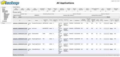

You can check it from YARN Resource Manager UI (RM UI).
From Ambari YARN page, open RM UI
From RM UI, you can have a look at the application which are running under YARN. From there you can look into memory consumption by each application, and compare your clusters for discrepancy.
RM UI showing list of apps (with Allocated Memory).
You can click on a specific app to have a detailed look on queue and memory used.

thx for this details , I opened the page and I see many spark app opened , so do you think if I will restart the spark it will solved this isshue
