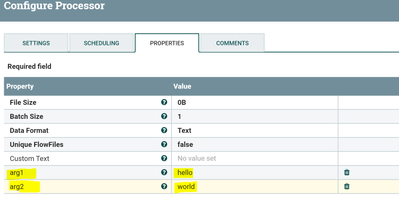

Generateflowfile Configs:-
Added two attributes arg1,arg2 to the flowfile

Now we are using the attributes that added in generateflowfile processor and passing them to the script.
