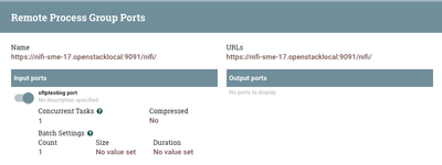

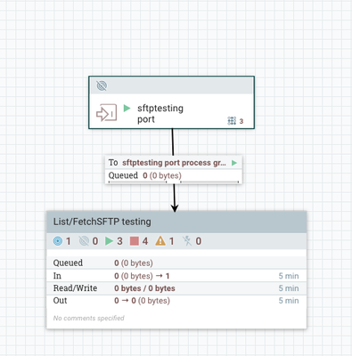

@dhieru singh
The flow would look something like this:
The output from the ListSFTP would go to the Remote Process Group which has the NiFi URL of one of the nodes.
There will need to be an inport port at the root level of the NiFi UI, you will use to connect to from the ListSFTP
And then the output from that port will go to the FetchSFTP, which in my example is in a process group
Do you follow?
