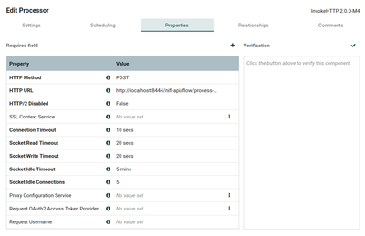

I am looking to control processers from NiFi iteslf. I learn that can be possible with Nifi Rest Api. But i am not able to connect api with InvokeHTTP processor. I am using NIFI 2.0.0-M4

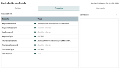

At first  I have tried to access it with StandardSSLContextService2.0.0-M4 by saving certificate and then use it from java keystore

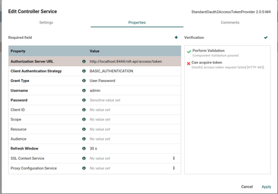

Then i tried to remove SSL certificate and disable all remote securities to push Nifi with "http". Here i tried with StandardOauth2AccessTokenProvider 2.0.0-M4. but it is still showing below error

From the image shared, I see the NiFi URL is "http" and not "https".  If your have you NiFi setup unsecured (HTTP), no NiFi authentication is going to be used even if setup in the NiFi core configuration files.    If your NiFi was secured (HTTPS), you would still need a StandardRestrictedSSLContextService to at least provide a truststore that contained the complete trust chain for the ServerAuth certificate used in the NiFi nifi.properties keystore to establish the 1-way TLS connection before you would be able to redirect to the oauth2 endpoint to get a token.  The other issue is you are not fetching a token from your oauth2 provider, but rather trying to fetch a token from whichever NiFi login provider you have configured.  That is because the "rest-api/access/token" endpoint is used for the NiFi login providers (ldap-provider or kerberos-provider).

If i removed all credentials and methods to access it with "http". If goes to No retry. Below is the InvokeHTTP configuration
Next i try with StandardRestrictedSSLContextService.

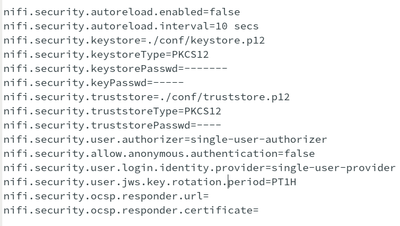

I use details from nifi.properties to configure service.
use same details to configure service
but it is till goes to No retry.
Here URL is ="https://localhost:8443/nifi-api/flow/process-groups/11d11155-1f75-15c9-4802-91f2b21aec2e"

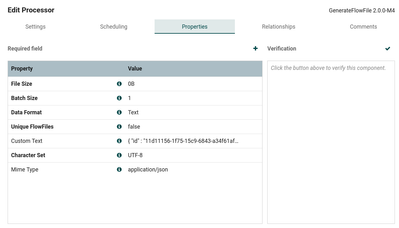

and passing payload ={"id":"11d11156-1f75-15c9-6843-a34f61aff12d","state":"RUNNING"}

So I see you are trying to start a Process Group (which starts all the NiFi components within that process group).   You are not setup with a production ready certificate nor production ready authentication and authorization configuration which makes setting up the necessary authorizations not possible.  You would need to switch to using the managed authorizer which allow you to use the file-user-group-provider.  This provider will allow you to define your NiFi node certificate DN as a user which you can then authorize as needed to make the rest-api call you want to make.
