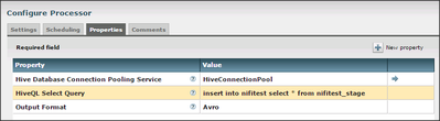

The above is the correct way to do it. However, there is also a workaround; by using the SelectHiveQL processor, you can write an insert statement as below.

@Eyad Garelnabi,
I am using PutHiveql along with ReplaceText.
Data flow is running succesfully but my insert-select did not execute because final table is empty in which I am performing insert-select.
In replace text properties, I have left the search value as default and in Replacement Value I have written my insert-select query.
When I checked the log, I found below error:
Could not open client transport with JDBC Uri: jdbc:hive2://sandbox.hortonworks.com:2181/testdb: null
