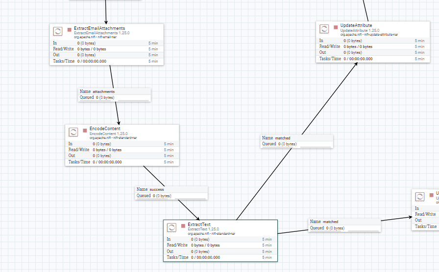

This idea is the picture will be sent through email , after we read and and convert to base64 String to we try to sent to oracle db by put sql process and insert statement ,
but we the received the following issues :
java.sql.BatchUpdateException: ORA-01704: string literal too long  Untitled picture.png
Note : The type of picture filed is long raw
