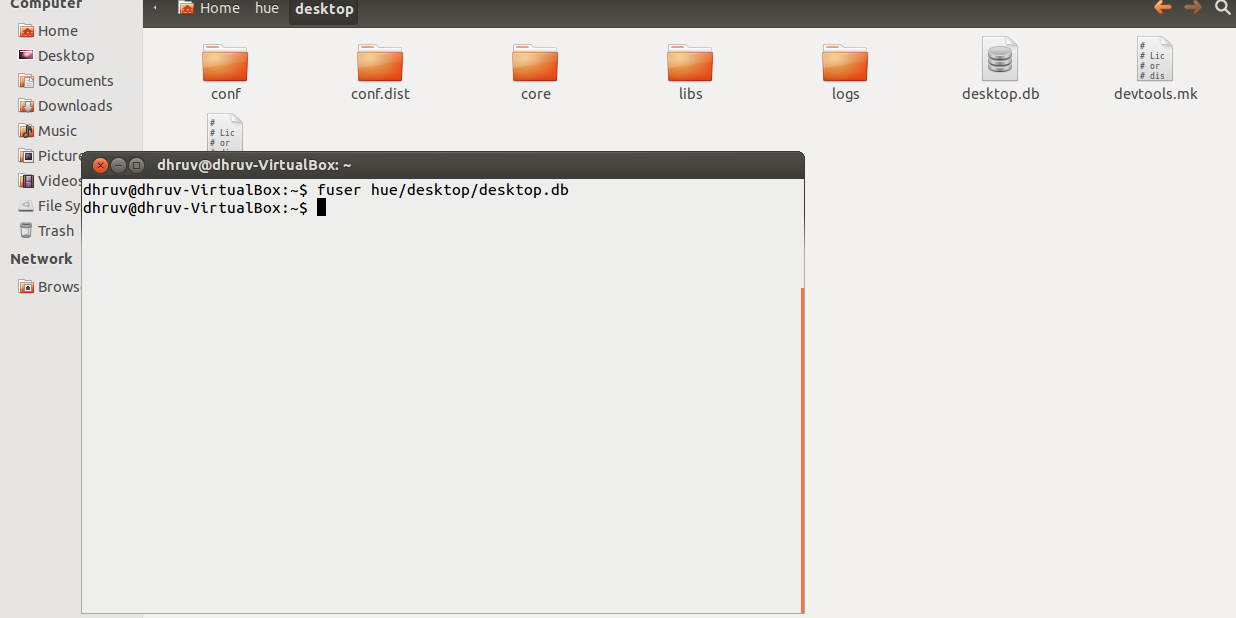

It gives me error "database is locked".
Rising Star
if it is a VM and you are doing practice then follow below tasks
Assumption: You are using SQLITE and not configured Hue with external database
fuser /var/lib/hue/desktop.db
It will give process id.
kill -9 processid
Note: database location may vary based on your configuration

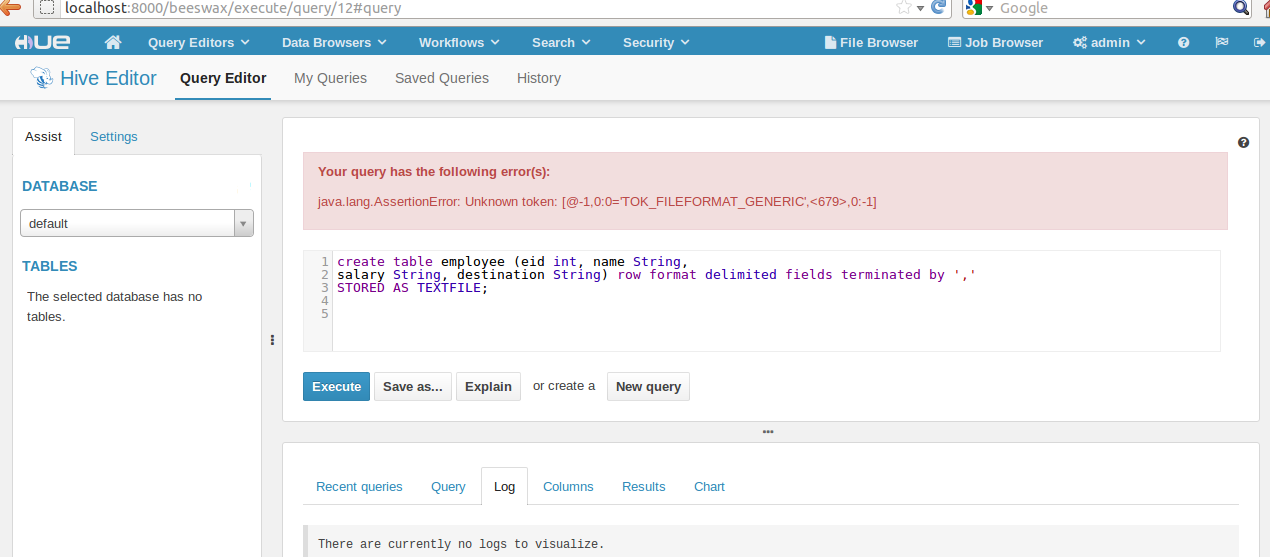

You are right. I've configured hive-site.xml & hive-env.sh. Now i can run create table quiries but without "STORED AS TEXTFILE".
This query works fine.
create table employee (eid int, name String,salary String, destination String) row format delimited fields terminated by ',';
I think some one has already opened this issue for hive 1.1.1.
https://issues.apache.org/jira/browse/HIVE-10831
With stored as text file clause i got this error.
