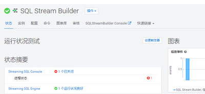

install Streaming SQL Console error
Explorer
cdp7.1.6
SQL_STREAM_BUILDER-1.12-csa1.4.1.0-cdh7.1.6.0-297-15479260

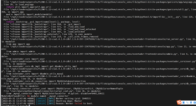

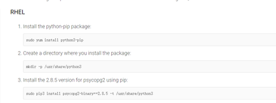

@dfdf as the error suggests:  You need to install the mysql connector.  I believe this link will get you there:
https://docs.cloudera.com/csa/1.3.0/installation/topics/csa-ssb-configuring-mysql.html#ariaid-title3
Explorer

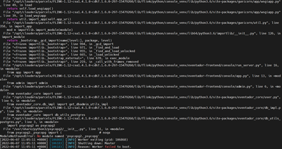

According to the above documents to install psycopg2, error remains
Explorer
after install ,error remains
Expert Contributor
Fun with python,  you are going to need to resolve all dependencies.  I am not familiar with the last error, but its definitely saying psycopg2 is not found..

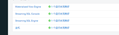

Follow the steps to install, lack _psycopg psycopg2 package. Py files
The solution
1:wget https://github.com/psycopg/psycopg2/archive/refs/tags/2_8_5.tar.gz
2:tar -xf 2_8_5.tar.gz
3:python setup.py build
   python setup.py install
4:cp psycopg2-2.8.5-py3.7-linux-x86_64.egg/psycopg2 /usr/share/python3
