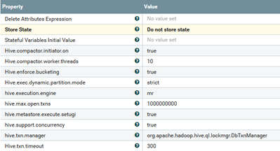

Thanks for these details. I will try all this and see if I can get this fixed . The basic issue we are facing here is when we are trying to insert data into a partitioned hive table using "put hive streaming" processor . The issue that we are getting is as follows :-
org.apache.nifi.util.hive.HiveWriter$CommitFailure: Commit of Txn 36315 failed on EndPoint: {metaStoreUri='thrift://caplifs0c.telecom.tcnz.net:9083', database='adhoc', table='nifi_s_order_test1', partitionVals=[2015-10-26] }
Do you by any chance have an idea how to fix this issue . The "PutHiveStreaming" works fine for a non partitioned table but as soon as we have this set to a partitioned table , we start seeing these issues. Actually , we set all the required hive parameters in the update attribute processor just before the put hive streaming processor. Screen shot below :-
Have you used the put hive streaming processor to insert data into a partitioned table ?

Hi @Shu
Thanks - this is now fixed. We realized the Nifi Nodes werent added to the hadoop topology which is why we were getting that error. This has been added and the data is going through !!
Thanks for all the help .. Have accepted your answer ..
