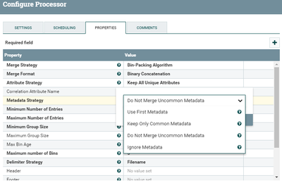

i tried to did it like getting files from get file(2 processors and then mergecontent-->Putfile)..
Hi Michel,
I am having different metadata in all the files except one common column. So which property i should use for Metadata Strategy in merge content processor.

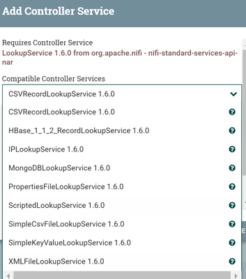

LookupRecord processor supports all these controller services to
Load your inputfile2 in one of the lookup services then use LookupRecord to look for deptid value then add the value to the record.
Refer to this and this links to get more details regarding configuration and working with LookupRecord processor.
