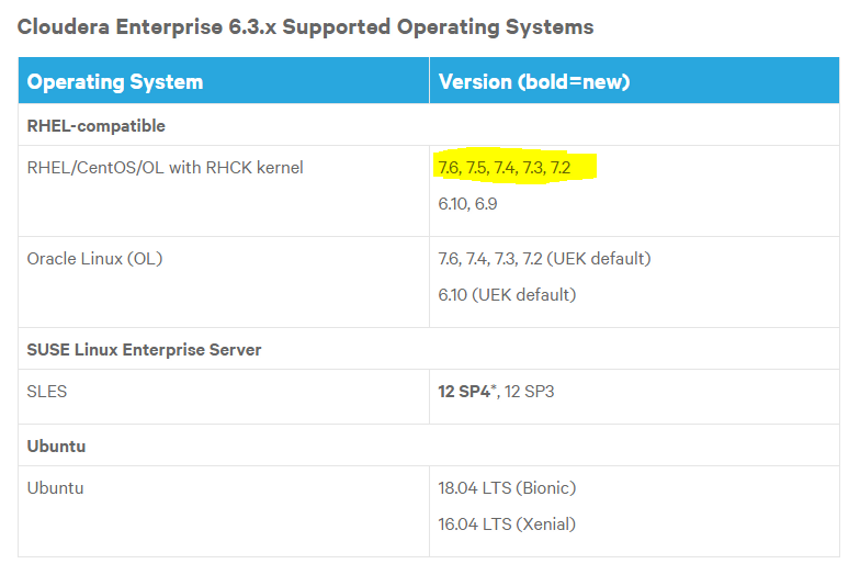

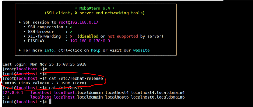

Bingooooooooo !  You are trying to install CDH on Operating System that is not certified no wonder all this headache I can now go to sleep.
We NEVER stress enough before embarking on deploying a software HDP or CDH you MUST read the vendor's release notes and most important the compatibility matrix. Not heeding to these pre-requisites always leads to a very bad first experience.
I downloaded and fired up your VM successfully, I then started form the basics Memory, CPU and networking then I saw a strange UI so checking the version confirmed my fears
Unsupported OS
Cloudera Compatability Matrix
Reference:
https://docs.cloudera.com/documentation/enterprise/6/release-notes/topics/rg_os_requirements.html#c6...
Currently, Centos/RHEL 7.6 is the  latest  compatible version so no need to proceed  further with investigations
Happy hadooping

Master Mentor
@Harisc4y
Unsupported OS
Reference:
Happy hadooping
