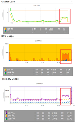

Hi:
after the execution,i saw this graphic but i think its normal??? i dont know why at this moment after minutes get the error
16/02/17 10:02:52 INFO mapreduce.Job: map 99% reduce 33%16/02/17 10:02:56 INFO mapreduce.Job: map 100% reduce 33%16/02/17 10:03:01 INFO mapreduce.Job: map 100% reduce 67%
