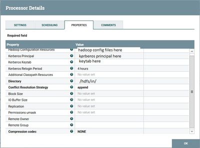

Please share your PutHDFS processor configuration with us.
How large are the individual files that are being written to HDFS?

a file is only 1-2 kb file.
configuration is
concurrent tasks; 1, rest are not changed.
