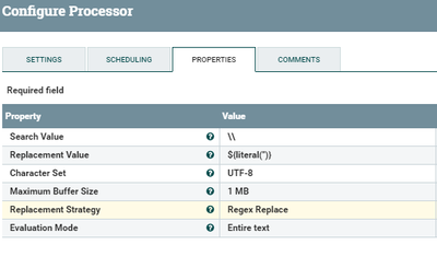

What you can do to overcome \ issue is after your first Replace Text Processor(that adds \ before $) add another Replace text processor with below configs.
Search Value
\ //search for \(backslash) literal
Replacement Value
${literal('')}  //replace \ with empty

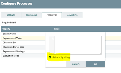

(or)
Instead of keeping above value(${literal('')}) you can click on check box that is shown below
Both methods above will result same empty string as Replacement Value.
Maximum Buffer Size
1 MB
Replacement Strategy
Regex Replace
Evaluation Mode
Entire text
Configs:-
Example:-
Input:-
\$\$\$\$\$\$\$\$hi\$\$\$\$\$\$\$\$
Output:-
$$$$$$$$hi$$$$$$$$
By using two Replace Text processors in series we are going to replace \ that is added in first replace text processor.
Search Value
Replacement Value
(or)
Maximum Buffer Size
1 MB
Regex Replace
Evaluation Mode
Entire text
Configs:-
Example:-
Input:-
Output:-
$$$$$$$$hi$$$$$$$$
Rising Star
It works, Thanks alot @Shu
