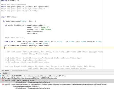

Hi All,
im trying to convert case class to StryctType schema in spark, im getting error attached in image,
please find my case class and conversion technique
case class Airlines(Airline_id: Integer, Name: String, Alias: String, IATA: String, ICAO: String, Callsign: String, Country: String, Active: String)
val AirlineSchema = ScalaReflection.schemaFor[Airlines].dataType.asInstanceOf[StructType]
Reference URL:
https://stackoverflow.com/questions/36746055/generate-a-spark-structtype-schema-from-a-case-class
Cheers,
MJ

Re: spark + scala schema creattion error
@Manikandan Jeyabal
Perhaps you can try this out:
import org.apache.spark.sql.Encoders
Encoders.product[Airlines].schema
Also there are some examples of use of case class in the following example:
https://github.com/apache/spark/blob/master/examples/src/main/scala/org/apache/spark/examples/sql/Sp...
Let me know if this helps!
Contributor
Hi @Felix Albani,
Tanx for your response, actully I've tried all the possible options,
please find the attached image for reference. is there any other way i can solve my issue ?
Cheers,
MJ
Highlighted
@Manikandan Jeyabal
The problem perhaps could be at the project level then. Could you check your pom file and make sure you have all necessary spark depenedencies. I tried this in zeppelin ui and is working fine:
Also make sure you clean/build and perhaps exit eclipse just in case there is something wrong with eclipse.
Finally here is a link on how to setup depenedecies eclipse:
https://community.hortonworks.com/articles/147787/how-to-setup-hortonworks-repository-for-spark-on-e...
HTH
*** If you found this answer addressed your question, please take a moment to login and click the "accept" link on the answer.
Highlighted
Contributor
Hi @Felix Albani
just for an clarification this will work only on Hortonworks dependencies ? please find my build.sbt dependencies and let me know whether i needs to add anything
val sparkVersion = "2.2.1"val hadoopVersion = "2.7.1"val poiVersion = "3.9"val avroVersion = "1.7.6"
libraryDependencies ++= Seq( "org.apache.spark" %% "spark-core" % sparkVersion, "org.apache.spark" %% "spark-sql" % sparkVersion, "org.apache.spark" %% "spark-hive" % sparkVersion, "org.apache.poi" % "poi-ooxml" % poiVersion, "org.apache.poi" % "poi" % poiVersion, "org.apache.avro" % "avro" % avroVersion )
Highlighted
Contributor
Hi @Felix Albani,
Still the same issue Exists, please find my attached build.sbt and sample code attached.
import sbt._ import sbt.Keys._ name := "BackupSnippets" version := "1.0" scalaVersion := "2.11.8" val sparkVersion = "2.2.1" val hadoopVersion = "2.7.1" val poiVersion = "3.9" val avroVersion = "1.7.6" val hortonworksVersion = "2.2.0.2.6.3.79-2" conflictManager := ConflictManager.latestRevision /*libraryDependencies ++= Seq( "org.apache.spark" %% "spark-core" % sparkVersion, "org.apache.spark" %% "spark-sql" % sparkVersion, "org.apache.spark" %% "spark-hive" % sparkVersion, "org.apache.poi" % "poi-ooxml" % poiVersion, "org.apache.poi" % "poi" % poiVersion, "org.apache.avro" % "avro" % avroVersion )*/ /*resolvers ++= Seq( "Typesafe repository" at "https://repo.typesafe.com/typesafe/releases/", "Typesafe Ivyrepository" at "https://repo.typesafe.com/typesafe/ivy-releases/", "Maven Central" at "https://repo1.maven.org/maven2/", "Sonatype snapshots" at "https://oss.sonatype.org/content/repositories/snapshots/", Resolver.sonatypeRepo("releases") ) */ libraryDependencies ++= Seq( "org.apache.spark" %% "spark-core" % hortonworksVersion, "org.apache.spark" %% "spark-sql" % hortonworksVersion, "org.apache.spark" %% "spark-hive" % hortonworksVersion) resolvers ++= Seq("Hortonworks Releases" at "http://repo.hortonworks.com/content/repositories/releases/", "Jetty Releases" at "http://repo.hortonworks.com/content/repositories/jetty-hadoop/")
package BigData101.ORC import ScalaUtils.SchemaUtils import org.apache.spark.sql.{Encoders, Row, SparkSession} import org.apache.spark.sql.catalyst.ScalaReflection import org.apache.spark.sql.types.StructType object ORCTesting { def main(args: Array[String]): Unit = { val spark: SparkSession = SparkSession.builder() .master("local[*]") .appName("ORC Testing") .enableHiveSupport() .getOrCreate() case class Airlines(Airline_id: Integer, Name: String, Alias: String, IATA: String, ICAO: String, Callsign: String, Country: String, Active: String) //val AirlineSchema = ScalaReflection.schemaFor[Airlines].dataType.asInstanceOf[StructType] Encoders.product[Airlines].schema sys.exit(1) } }
Highlighted
@Manikandan Jeyabal
I think there may be a project level problem on yours. Therefore I'm sharing a very simple dummy project that is compiling fine in my environment (this is only shared as an example and is not meant to be used in real production):
sparktest.zip
Hopefully with this project you will be able to figure out what is wrong when comparing with yours. Note: You can use command line sbt compile and sbt package to get the jar
This is the output I get when I run it:
 SPARK_MAJOR_VERSION=2 spark-submit /root/projects/sparktest/target/scala-2.11/hello_2.11-0.1.0-SNAPSHOT.jar Hello
SPARK_MAJOR_VERSION is set to 2, using Spark2
hello
root
 |-- Airline_id: integer (nullable = true)
 |-- Name: string (nullable = true)
 |-- Alias: string (nullable = true)
 |-- IATA: string (nullable = true)
 |-- ICAO: string (nullable = true)
 |-- Callsign: string (nullable = true)
 |-- Country: string (nullable = true)
 |-- Active: string (nullable = true)
HTH
Highlighted
Contributor
Hi @Felix Albani
yes your suggestion works fine, i think i have to extend my object as app to make it work. Tanx Bro.
