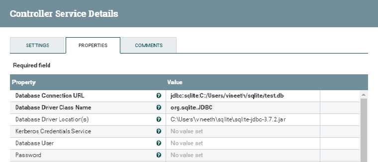

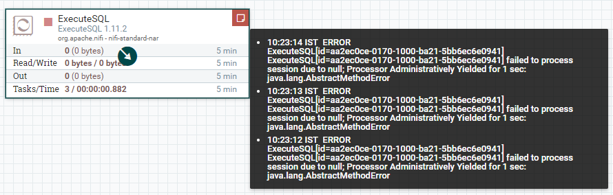

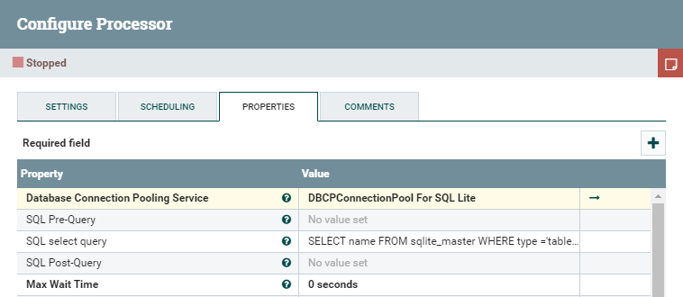

I am new to Nifi and trying to connect to SQLite Database and from there want to fetch
1. List of the tables
2. Table details based on selected tables by users.
But when trying to connect SQLite it is failing throwing an error "Failed to process session due to null" attaching the screenshot of what I did (not able to understand where I am doing mistake) any help will be great.sql_lite_configure_processor.pngsql_lite_controller_service.pngsql_lite_error.png

Hi All,
I was able to solve the above problem (the issue was jar file which I was referring was outdated) but now facing another issue attaching the screenshot of that
