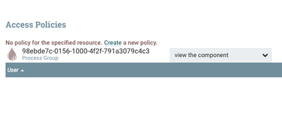

Now I am going as per your post and trying to set Access Policies. As per your post " we can create a policy for the root process group by clicking the key icon in the operate palette on the left" but this key icon does not work. its not grey but it doesn't open any popup. is there any catch behind this? i checked user logs as well but find nothing.
Master Guru
Clicking the lock icon should bring up the policies window:
What browser are you using? You may want to look for Javascript errors to see if something is going wrong client side?
