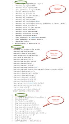

Parameters
This is an important piece for tuning. To benchmark your environments parameters should be configured. Much of this is trial and error. I would say experience is required here. ie How each parameter impacts a MapReduce job. Get help here.
For tuning change/add parameters here:
For ease of first time execution, use the ones set in the script. Run it as is and grab your stats. If the stats are acceptable then move on. What is acceptable? Take a look the articles I published on BigStep and AWS. If stats not acceptable, starting tuning.
