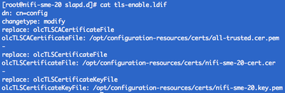

Next update the slapd service to use the CA and server certificate. This is done by updating the
/etc/openldap/slapd.d/cn=config.ldif file. The file cannot be edited manually, you have to update the file by using the ldapmodify command. One way to do this is create your own file.ldif file with the updates needed and then use this file as a parameter on the ldapmodify command. For this article, I created a file called tls-enable.ldif, here is a copy of the file:
TLSCertificateFile this directive specifies the file that contains the slapd server certificate
TLSCACertificateFile this directive specifies the PEM-format file containing certificates for the CA's that slapd will trust
TLSCertificateKeyFile this directive specifies the file that contains the private key that matches the certificate stored in the TLSCertificateFile file.
Note: To use the private key, we need to decrypt it, this can done with the following command:
openssl rsa -in nifi-sme-20.key.enc.pem -out nifi-sme-20.key.pem
The command used to update the cn=config.ldif is:
ldapmodify -Y EXTERNAL -H ldapi:/// -f tls-enable.ldif

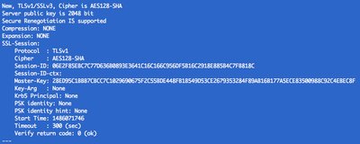

Now verify that you are able to connect to the slapd service, run the following command:
openssl s_client -connect nifi-sme-20:636 -debug -state -CAfile /opt/configuration-resources/certs/all-trusted.pem
If the commands works, output similar to this is displayed
This will put you into a shell , which you can use control-c to exit. In addition, if you check the status of the slapd service, you will also see the connection from the above command

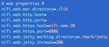

First, configure NiFi to perform user authentication over HTTPS, the following sections in the nifi.properties file section need to be completed. Again for this example, the configuration is being done on system nifi-sme-20.
Make sure to set the web section to use https host and port

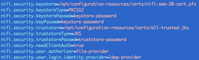

In addition, fill in the security section with the keystore and truststore. In this example, I use the same CA certificate in the nifi.properties as the ldaps service, but it isn't a requirement for it to work with NiFi. The CA used in the configuration of the login-identity-provider.xml has to be the same as the one used in the configuration of the ldaps service.
Notice also that the nifi.security.user.login.identity.provider is set to ldap-provider. Now edit the login-identity-provider.xml file and add the keystore, truststore and all of the other TLS properties. Once you set the authentication strategy to LDAPS, all of the other properties are required to have some value. Inside the file is short explanation of each property and the possible values.

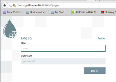

This is what you will see when you go to the NiFi UI in the browser:
And there you go, you have successfully configured NiFi to use LDAPS.
