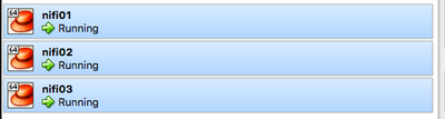

Start the virtual machines
Once you have created the 3 files in your Vagrant project directory, you are ready to start your cluster. Creating the cluster for the first time and starting it every time after that uses the same command:
$ vagrant up
Once the process is complete you should have 3 servers running. You can verify by looking at VirtualBox. You should notice I have 3 virtual machines running called nifi01, nifi02 and nifi03:
