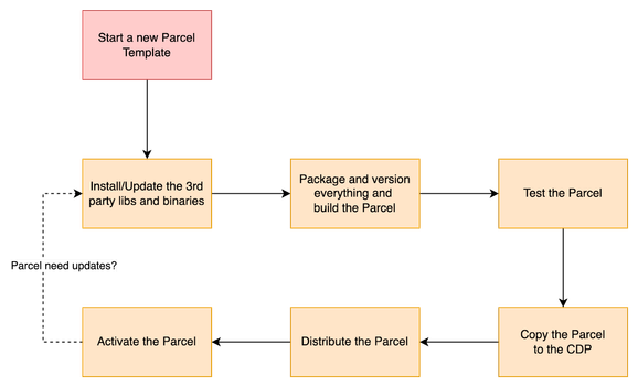

Solution Lifecycle
The diagram below explains the lifecycle of the proposed solution:
As you may have noticed, the dotted line represents that a change was required, and therefore, a new version should be built.
In the next steps, for illustrative purposes only, we will create a customized version of a Parcel containing Python 3.6 and the Pandas library.

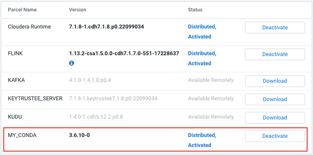

STEP 5: Install and distribute the Parcel
  1. Copy the parcel and the sha files to the /opt/cloudera/parcel-repo directory in the Cloudera Manager node.
  2. Change the permissions:
    sudo chown cloudera-scm: /opt/cloudera/parcel-repo/MY_CONDA-3.6.10-0-el7.parcel*
  3. Go to Cloudera Manager > Parcels, and click Check for New Parcels
  4. After the parcels are detected, click Distribute
  5. Click Activate to activate the Parcel
  6. Make sure everything is working in all nodes:
    /opt/cloudera/parcels/MY_CONDA/miniconda3/bin/python --version
