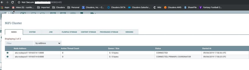

Few minutes later you will have a fully functioning NiFi cluster on Kubernetes
