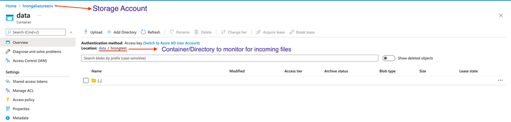

Create a Azure storage container/directory
  1. Create an Azure Storage account and create a container/directory that we want to monitor for incoming files

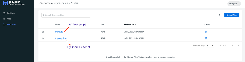

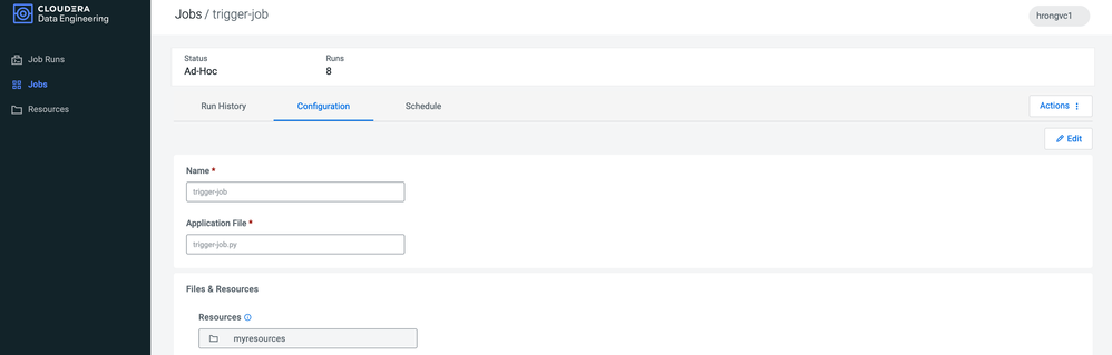

Create CDE components - Resources, Jobs

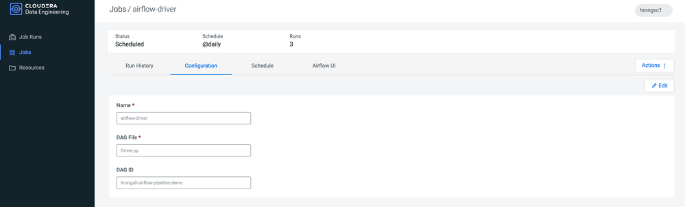

Create Airflow and/or Spark jobs in CDE following these instructions

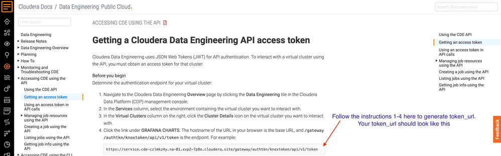

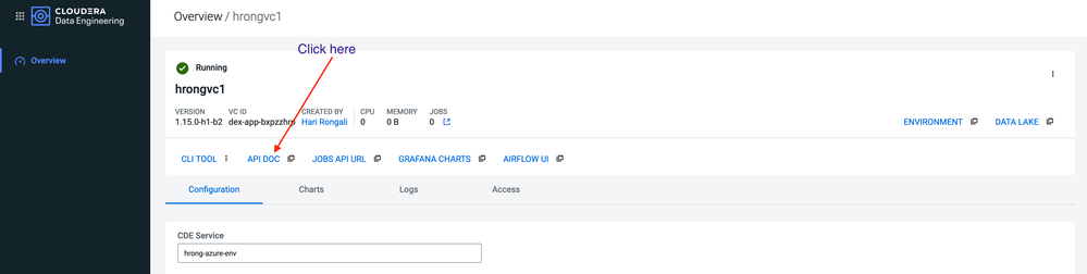

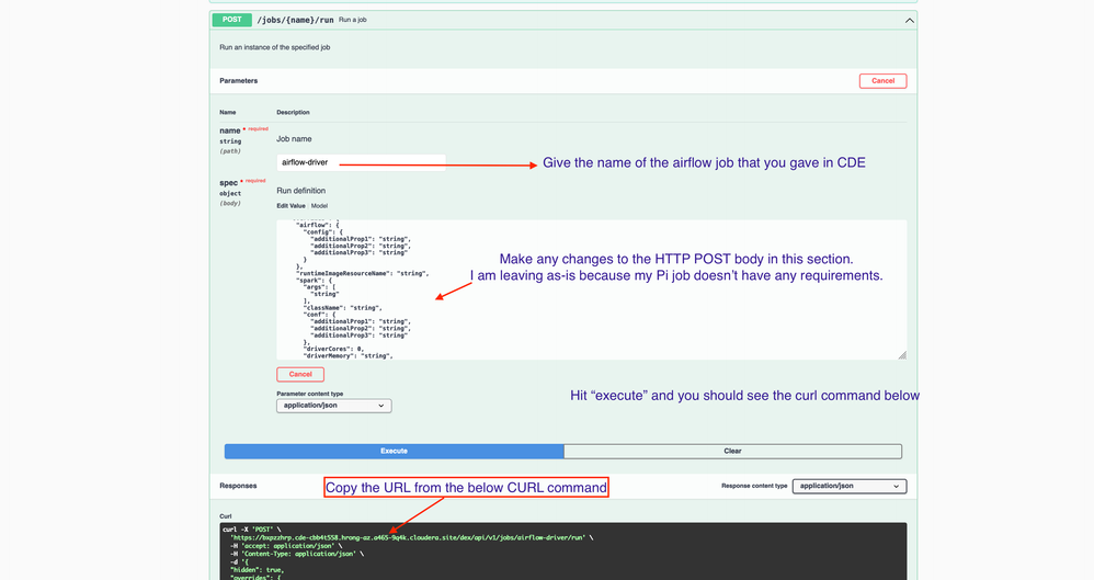

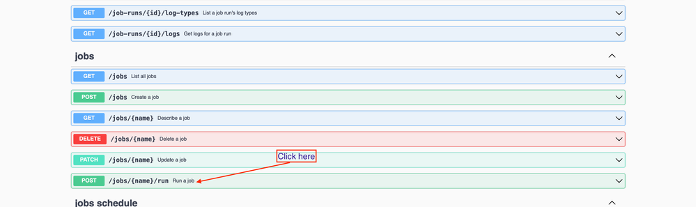

Collect CDE URLs required to trigger Spark/Airflow jobs
Gather the JOBS API URL for the airflow/spark job and token_url for retrieving the AUTH token
  • JOBS API URL:
Get the TOKEN URL for extracting the AUTH token for authentication purposes

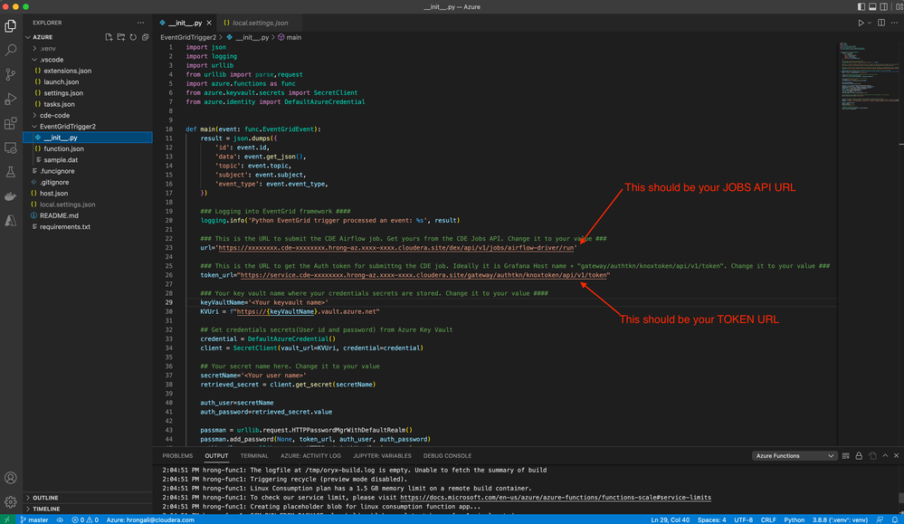

Create Azure functions App and Azure python function
  1. Create Azure function App with python flavor and create Azure python function:
    1. Follow the instructions here to create a Azure function App with Python/Linux flavor
    2. Configure a local Azure functions development environment with something such as Visual Studio code with Azure plugins installed. Choose "Azure Event Grid Trigger" template in Step#4 of the document instructions.
    3. Example Azure Event Grid function can be found here. Make changes to the function according to your environment.
      2. You might need python dependencies as well to run your Python azure function and you might have installed your dependencies in your local development environment in your virtual environment. You should be able to do a
pip freeze > requirements.txt​
 from your local root project folder structure to collect all your python dependencies into requirements.txt file.

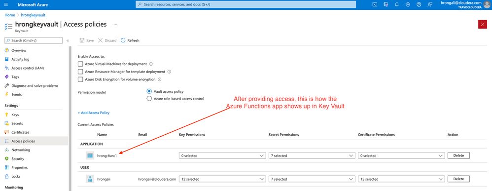

Create Azure key vault and provide access to Azure python function
  1. Cloudera Data Engineering uses JSON Web Tokens (JWT) for API authentication and you may need user id and password to get the token. Obtaining the token programmatically is covered in the Azure function code itself, but you might have to store the user id and password in a secure location within Azure such as Azure Key Vault by creating a secret.
    • Provide access to Azure function to the Azure Key Vault by adding an "Access Policy". I followed this blog to make this integration work.

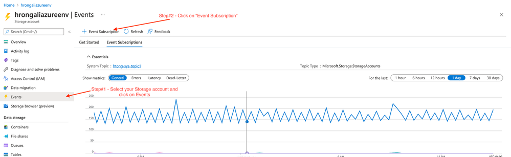

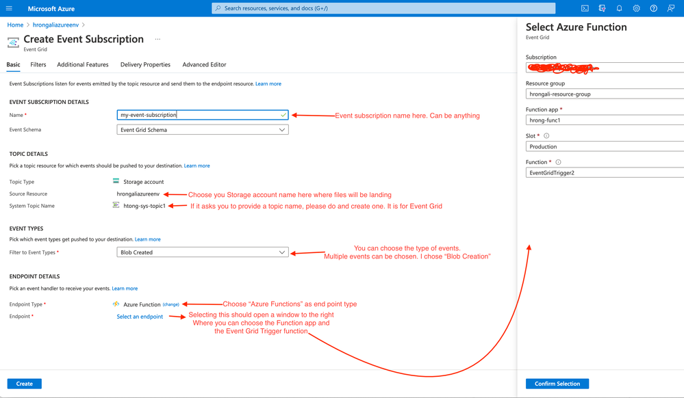

Create Event Grid subscription on storage account and configure filter to the directory to be monitored

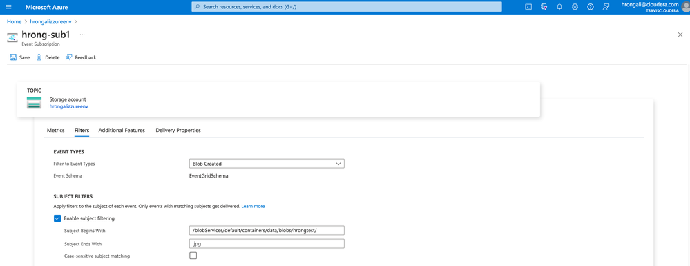

  1. Create Event Grid Subscription on the Storage Account and configure a filter to monitor only the required container/directory -- This is very important, otherwise you will end up with function triggers for every storage container activity(Be careful and test your filter thoroughly)
    2.
    3. Choose the correct filter for the container/directory, you want to monitor. On the same page, click on the "Filters" tab and enable "Enable Subject Filtering" checkbox. In my case, I wanted to monitor hrongaliazureenv/data/hrongtest where hrongaliazureenv==My storage account, data==My Container inside my storage account and hrongtest==a directory inside my "data" container. My equivalent filter is:
/blobServices/default/containers/data/blobs/hrongtest/​

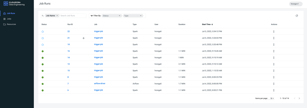

Start running the event driven pipeline with Event Grid/Azure functions and CDE

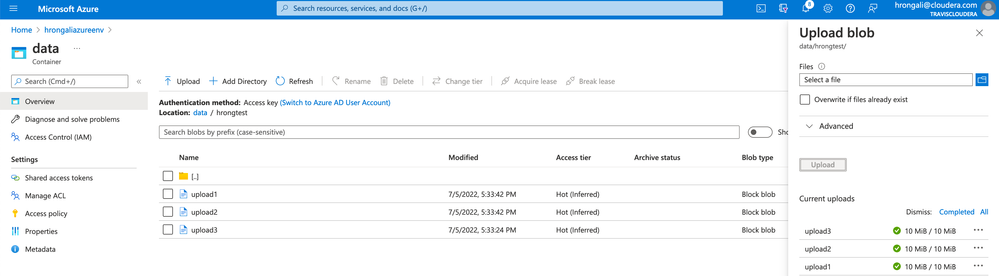

  1. Start uploading the blobs into the hrongtest directory in your storage account and you should see CDE Spark jobs running in CDE
    1. In this case, I have uploaded 3 blobs upload1, upload2 and upload3

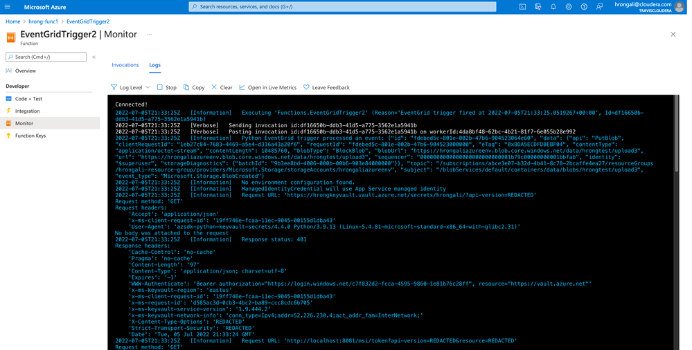

    2.  You should see logs from the Azure functions monitoring tab for each function invocations:
      1. From Azure functions --> MonitoringFrom Azure functions --> Monitoring
    3. You should also see the Azure functions triggering CDE Jobs from CDE console
