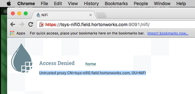

Troubleshooting node identities:
How will you know you made a mistake while setting node identities? Usually if the node identities field was not correctly set, when you attempt to open the Nifi UI, you will see an untrusted proxy error similar to below:
You will see some a similar 'Untrusted proxy' error in /var/log/nifi/nifi-user.log:
[NiFi Web Server-172] o.a.n.w.s.NiFiAuthenticationFilter Rejecting access to web api: Untrusted proxy CN=tsys-nifi0.field.hortonworks.com, OU=NIFI
In the above case, you would need to double check that the 'Node identity' values you provided in Ambari match the one from the log file (e.g. CN=tsys-nifi0.field.hortonworks.com, OU=NIFI) and ensure the values are not commented out. Next, you would manually delete /var/lib/nifi/conf/authorizations.xml from all nodes running Nifi and then restart Nifi service via Ambari.

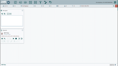

5. Check Nifi access
Now you open Nifi UI using the Quicklink in Ambari. After selecting the certificate you imported earlier, follow the below screens to get through Chrome warnings and access the Nifi UI:
a) Select the certificate you just imported
b) Choose "Always Allow"
c) Since the certificate was self-signed, Chrome will warn you that the connection is not private. Click "Show Advanced" and click the "Proceed to <hostname>" link
d) At this point, the Nifi UI should come up. On the left, it shows 3/3, meaning all three of the Nifi nodes have joined the cluster. Note that on the top right, it shows you are logged in as "CN=nifiadmin, OU=CLOUD.HORTONWORKS.COM"
e) The /var/log/nifi/nifi-user.log log file will also confirm the user you are getting logged in as:
o.a.n.w.s.NiFiAuthenticationFilter Authentication success for CN=nifiadmin, OU=CLOUD.HORTONWORKS.COM
f) Notice also that users.xml and authorizations.xml were created. Checking their content reveals that Nifi auto-created users and access policies for the 'Initial Admin Identity' and 'Node Identities'. More details on these files can be found here
cat /var/lib/nifi/conf/users.xml
cat /var/lib/nifi/conf/authorizations.xml
With this you have successfully enabled SSL for Apache Nifi on your HDF cluster
