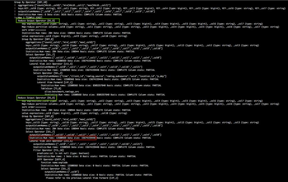

Let's look at the Explain plan.
2. The LONGGGGGG Explain Plan
Let's look at the relevant portions of this explain plan. We see in Red that in the Reducers stage, 14.5 TB of data, across 13 million rows are processed. This is a lot of data to funnel through just two reducers.
The final output of the reducers is just 190944 bytes (in yellow), after initial group bys of count, min and max.
We need to increase the number of reducers.

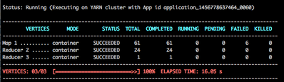

5. More reducers does not always mean Better performance
Let's set hive.exec.reducers.bytes.per.reducer to 15.5 MB about 15872
The new number of reducers count is
> Max(1, Min(1099, 190944/15360))  x  2
> Max (1, Min(1099, 12)) x 2 = 12  x 2 = 24
Performance is BETTER with 24 reducers than with 38 reducers.

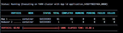

7. Reducing number of Reducer Stages
Since we have BOTH a Group By and an Order by in our query, looking at the explain plan, perhaps we can combine that into one reducer stage.
The parameter for this is hive.optimize.reducededuplication.min.reducer which by default is 4.
Setting this to 1, when we execute the query we get
Performance is BETTER with ONE reducer stage at 15.88 s.
NOTE: Because we also had a LIMIT 20 in the statement, this worked also. When LIMIT was removed, we have to resort to estimated the right number of reducers instead to get better performance.
