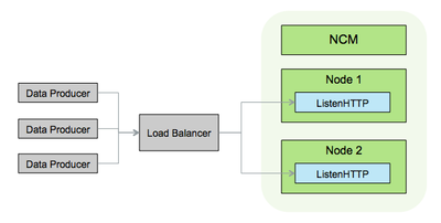

When a data source can push it's data to NiFi, there will generally be a processor listening for incoming data. In a cluster, this processor would be running on each node. In order to get the data distributed across all of the listeners, a load balancer can be placed in front of the cluster, as shown in the following example:
The data sources can make their requests against the url of the load balancer, which redirects them to the nodes of the cluster. Other processors that could be used with this pattern are HandleHttpRequest, ListenSyslog, andListenUDP.

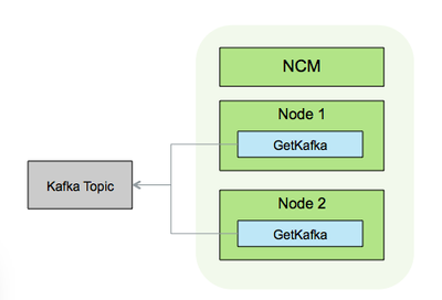

If the data source can ensure that each pull operation will pull a unique piece of data, then each node in the NiFi cluster can pull independently. An example of this would be a NiFi cluster with each node running a GetKafka processor:
Since each GetKafka processor can be treated as a single client through the Client Name and Group ID properties, each GetKafka processor will pull different data.

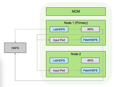

A different pulling scenario involves performing a listing operation on the primary node and distributing the results across the cluster via site-to-site to pull the data in parallel. This typically involves "List" and "Fetch" processor where the List processor produces instructions, or tasks, for the Fetch processor to act on. An example of this scenario is shown in the following diagram with ListHDFS and FetchHDFS:
ListHDFS is scheduled to run on primary node and performs a directory listing finding new files since the last time it executed. The results of the listing are then sent out ListHDFS as FlowFiles, where each FlowFile contains one file name to pull from the HDFS. These FlowFiles are then sent to a Remote Process Group connected to an Input Port with in the same cluster. This causes each node in the cluster to receive a portion of the files to fetch. Each FetchFile processor can then fetch the files from HDFS in parallel.

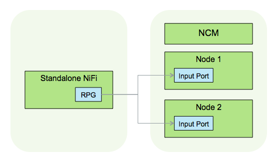

In the push scenario, the destination NiFi has one or more Input Ports waiting to receive data. The source NiFi brings data to a Remote Process Group connected to an Input Port on the destination NiFi.

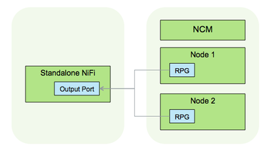

In the pull scenario, the destination NiFi has a Remote Process Group connected to an Output Port on the source NiFi. The source NiFi brings data the Output Port, and the data is automatically pulled by the destination NiFi.

Master Guru
Hi Samir,
There shouldn't be an end-less loop...
As you can see in the HDFS example diagram, there are two parts to the flow:
- ListHDFS -> RPG (this part only runs on primary node)
- Input Port -> FetchHDFS -> rest of the flow (this part runs on all nodes)
The starting point of your flow should be something that has no input, like ListHDFS, so there can't be a circular loop back to that point.
The end of the second part should end with wherever you are sending your data, like PutHDFS for example, after that it is dead end, no loop back to anywhere.
If this is not clear, please provide a screen shot or template of your flow so we can see how you have connected the processors.
Thanks,
Bryan
