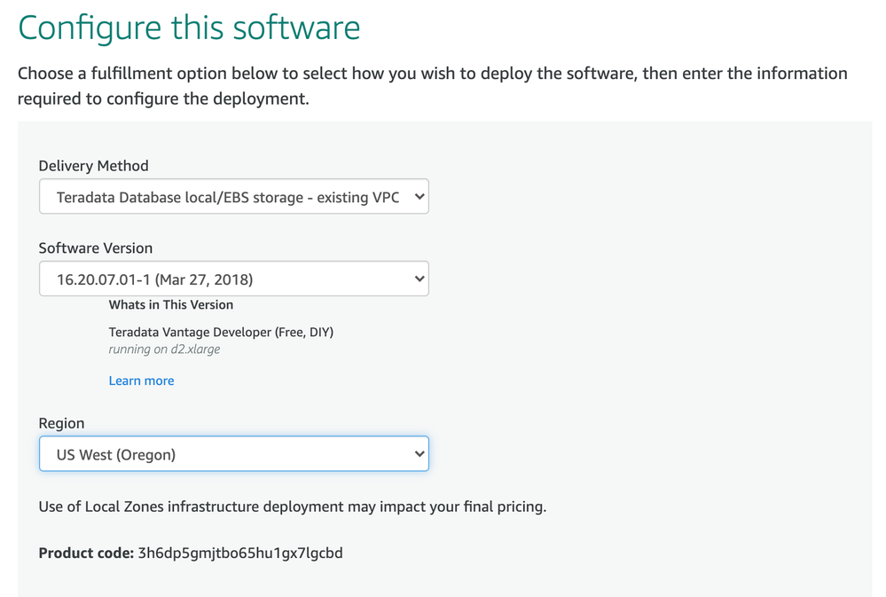

  1. Once the assets are created, go to Teradata Vantage Developer and select your configuration (make sure you select the same region as the assets you created):

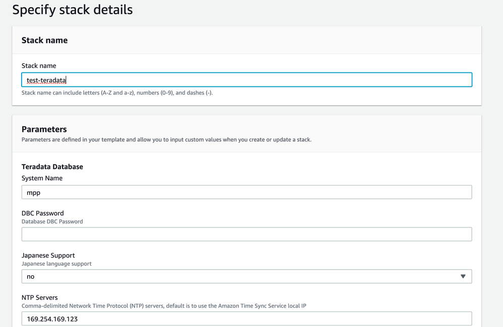

  2. From this configuration, launch the CloudFormation template and fill the parameters with the AWS assets you created:

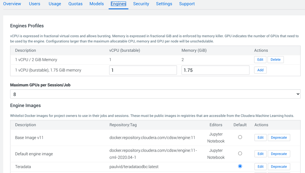

Step 2: Create a custom image with Teradata driver
  1. I created the following image by following the steps the documentation on custom engines
    #Dockerfile
    FROM 	docker.repository.cloudera.com/cdsw/engine:11-cml-2020.04-1
    WORKDIR /tmp
    #The RUN commands that install an editor
    #For example: RUN apt-get install myeditor
    RUN  apt-get autoremove unixodbc -y
    RUN  apt-get update -y
    RUN  apt-get install lib32stdc++6 -y
    RUN  apt-get install wget -y
    RUN wget [LOCATION_OF_DRIVERS]
    RUN tar -xzvf tdodbc1620__ubuntu_indep.16.20.00.87-1.tar.gz
    RUN dpkg -i tdodbc1620/tdodbc1620-16.20.00.87-1.noarch.deb
    RUN  apt-get install -y python-pyodbc
    A few notes on this image:
    1. I removed the unixodbc because I read that it was causing issues with pyodbc but it may not be required
    2. You can find a built image on my dockerhub here
  2. Finally, connect to CML and add this new engine:

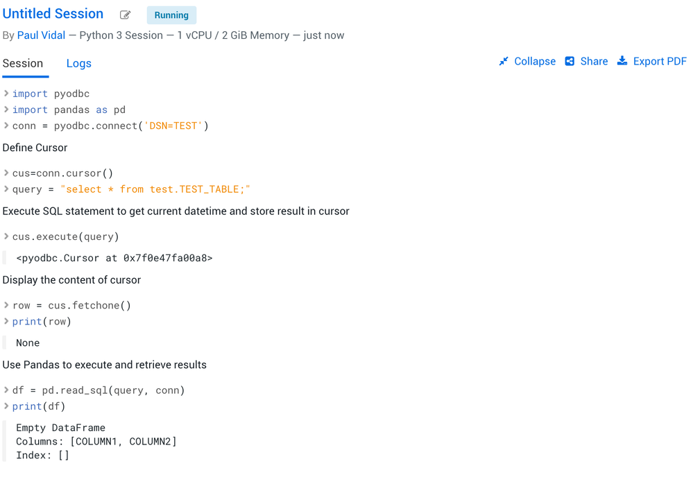

  5. Finally, you can run the following code to test:
    import pyodbc
    import pandas as pd
    conn = pyodbc.connect('DSN=TEST')
    # Define Cursor
    cus=conn.cursor()
    query = "select * from test.TEST_TABLE;"
    # Execute SQL statement to get current datetime and store result in cursor
    cus.execute(query)
    # Display the content of cursor
    row = cus.fetchone()
    print(row)
    # Use Pandas to execute and retrieve results
    df = pd.read_sql(query, conn)
    print(df)
The output in the workbench should look something like the following:
