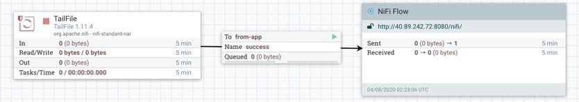

NiFi Stateless will pull an existing flow from NiFi Registry.  The following is a simple NiFi flow designed in NiFi:

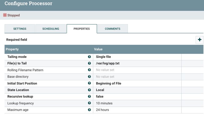

TailFile processor will tail the application log file /var/log/app.txt.  The application deployed will write log entries to this file:

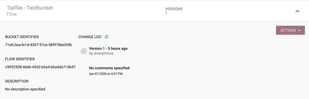

The flow is checked into NiFi Registry.  NiFi Registry URL, Bucket Identifier & Flow Identifier will be used by NiFi Stateless at run time. More about this soon.
