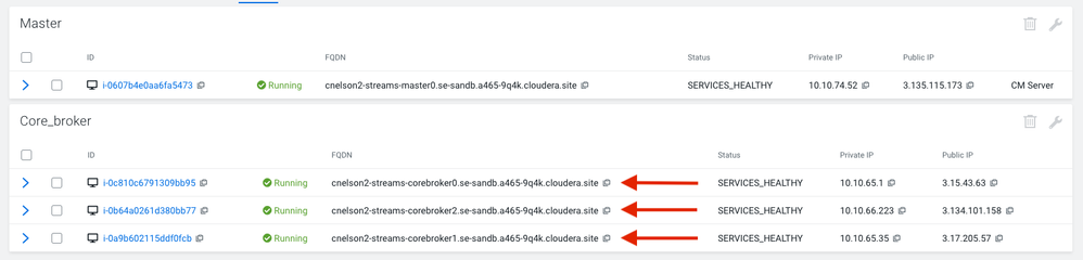

We'll need to create a few users and a database that will be used to connect into later.   You'll need to grab the hostnames of the broker nodes on your Streams Messaging data hub in order to create the user correctly.
SSH into your MySQL host and connect to the MySQL instance:
mysql -uroot -p
We need to create a user for each broker node in our data hub.   Feel free to use a more secure password if that's your thing:
create user cdc_user@'cnelson2-streams-corebroker0.se-sandb.a465-9q4k.cloudera.site' identified with mysql_native_password by 'Password1#';
create user cdc_user@'cnelson2-streams-corebroker1.se-sandb.a465-9q4k.cloudera.site' identified with mysql_native_password by 'Password1#';
create user cdc_user@'cnelson2-streams-corebroker2.se-sandb.a465-9q4k.cloudera.site' identified with mysql_native_password by 'Password1#';

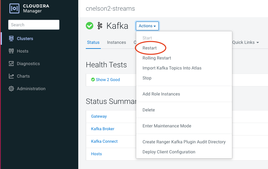

Once the jars are in place, you will need to restart Kafka services within Cloudera Manager.

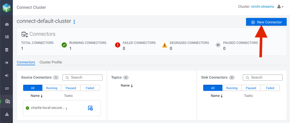

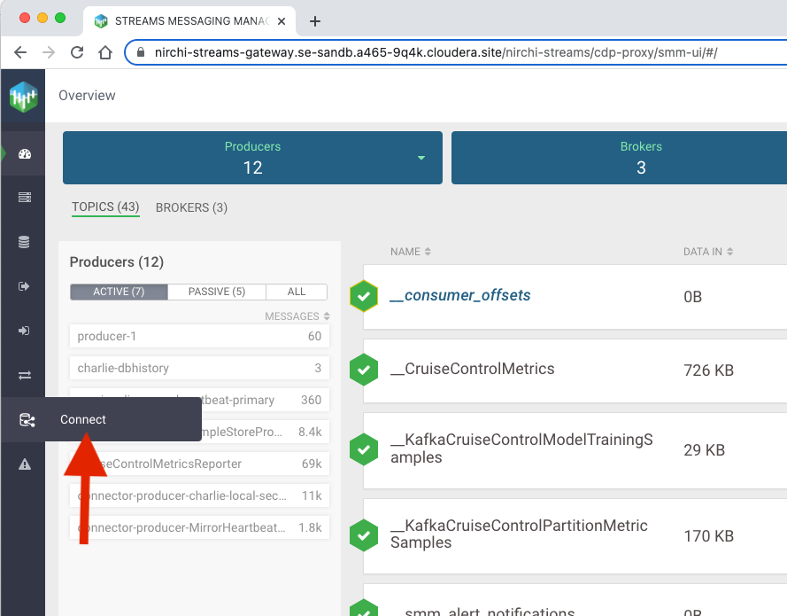

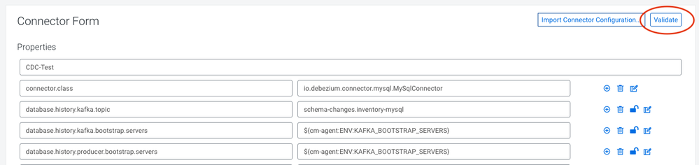

From your Streams Messaging data hub, open up the Streams Messaging Manager UI, and navigate to Connect on the left hand navigation bar.
Then click the button to create a New Connector.

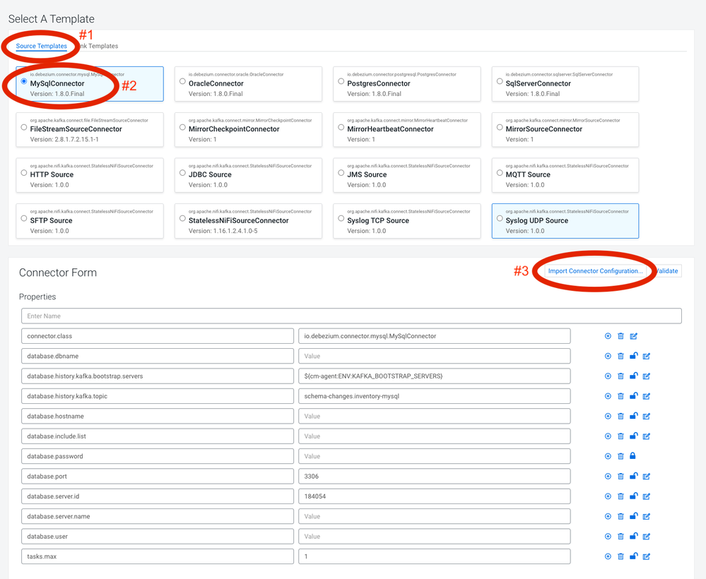

And select the MySqlConnector (#2 pictured below) as a Source Template (#1 pictured below).   This will open up a configuration pane with a series of key/value pairs for the connector configuration.   The default configuration is probably enough for a cluster without any security or kerberos in place, but CDP Public Cloud is fully secured so we will need to add quite a bit to this configuration.   You can set these config parameters manually in this interface, or you can upload an existing configuration which is what we'll do here.
 Click the Import Connector Configuration (#3 pictured above). and paste the below JSON into the window, making the necessary changes to reflect your cluster & MySQL details.

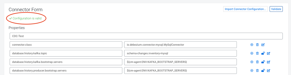

Validate the Configuration
Once the configuration is complete, you must first validate the configuration before you can deploy it.   Validating will ensure the necessary jars are in place, security parameters are correct, and check connectivity to the remote database.
If the validation process finds any issues, they will be presented either in the configuration box, or possibly as a red alert box in the upper right corner of your browser window.   Once you have a validated configuration, click Next, and then click Deploy.

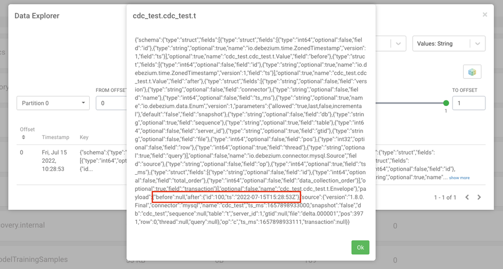

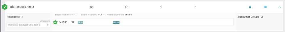

If everything is working, we should see a corresponding message in a kafka topic named based on the source database name, the database.server.name property, and the table name.   So in our case the topic will be named cdc_test.cdc_test.t, and we see it in Streams Messaging Manager:
And using the data explorer in Streams Messaging Manager, we can inspect the actual CDC payload.  It is a JSON object with a lot of useful information, but of particular interest to us is the payload key which includes a before & after view of the row.   Since we inserted a new row, the before version is null and the after version has the data we inserted.
