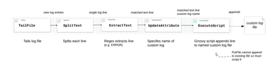

Single customized log

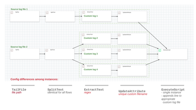

A single customized log is achieved by tailing a log file, splitting the lines of text, extracting lines that match a regex, specifiying a custom log filename for the regex-extracted lines, and appending the lines to that custom log file. The diagram below shows more details, which will be elaborated even more later in the article.
For example, you could extract all lines that are WARN and write them to its own log file, or all lines with a specific java class, or all lines with a specific processor name or id … or particular operation, or user, or something more complex.

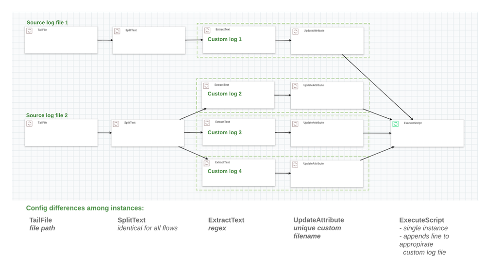

Multiple customized logs in same flow
The above shows only one custom logging flow. You can building many custom logs against the same source log file (e.g. one for WARN, one for ERROR, one for pid, and another for username … whatever.

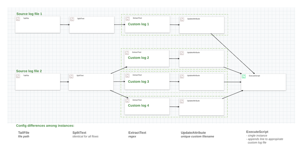

You can also build many custom log files against multiple source logs. The diagram below shows multiple customized logs in the same flow.
The above flow will create 4 separate custom log files … all written out by the same ExecuteScript.

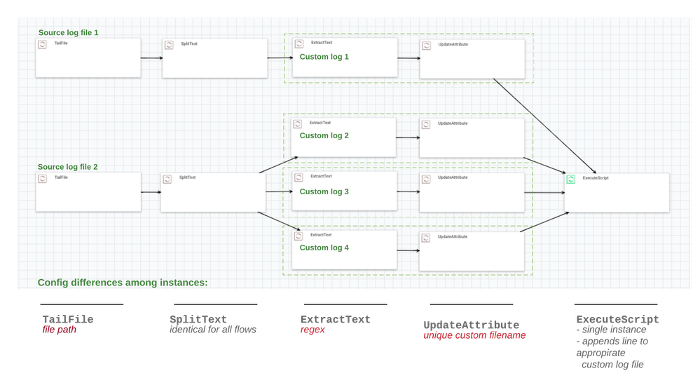

Add a new custom log: Good ol’ copy-paste
Note in the above that:
  • each custom log flow is identical except for 3 configuration property changes (if you are adding a custom logging against the same source log, only 2 configuration properties are different)
  • all custom logging reuses ExecuteScript to append to a custom log file: Execute script knows which custom file to append to because each FlowFile it receives has the matched text and its associated custom filename
Because all custom log flows are identical except for 3 configs, it is super-fast to create a new flow. Just:
  • copy an existing custom log flow (TailFile through UpdateAttribute) via SHFT-click each processor and connection, or lassoing them with SHFT-mouse drag
  • paste on palette and connect to ExecuteScript

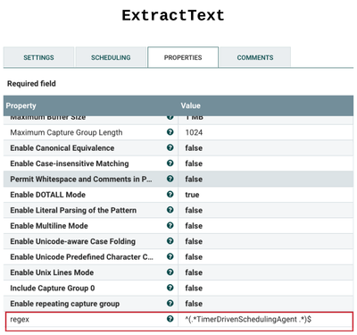

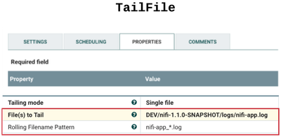

  • change the 3 configs (TailFile > File to Tail; ExtractText > regex; UpdateAttribute > customfilename)
Technical note: when you paste to the pallete, each processor and connection retains the same name but is assigned a new uuid, thereby guaranteeing a new instance of each.
Tidying up

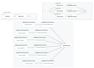

Because you will likely add many custom log flows to the same flow, and each source log file many split into multiple custom log flows (e.g. Source log file 2 above diagram) your pallete may get a bit busy. Dividing each custom log flow into the same logical processor groups helps manage the palette better. It also makes copy-pasting new flows and deleting other custom log flows easier.
Here is what it will look like.
Now you have your choice of managing entire process groups (copy-paste, delete) or processors inside of them (copy-paste, delete), thus giving you more power to quickly add or remove custom logging to your flow:
  • To add a custom log to an existing TailFile-SplitText: open the processor group and copy-paste ExtractText-UpdateAttribute then make a config change to each processor.
  • To add a custom log against a new source log: copy-paste any two process groups in the subflow, and make 1 config change in the first (TailFile), and necessary changes in the second process group (add/delete custom log flow, 2 config changes for each custom log)

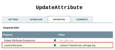

The config changes for each new custom log file
9140-nifi-cust-logging-config-changes-tail.png9141-nifi-cust-logging-config-changes-extract.png

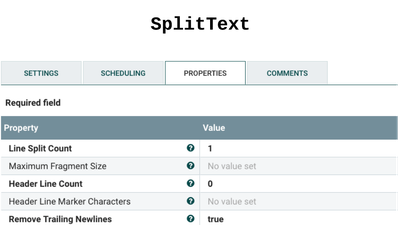

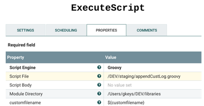

The configs that do not change for each new custom log
9143-nifi-cust-logging-configstatic-split.png9144-nifi-cust-logging-configstatic-execute.png
The groovy script
import org.apache.commons.io.IOUtils

Note that the jar for org.apache.commons.io.IOUtils is placed in Module Directory as set in ExecuteScript
