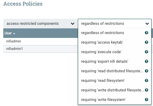

In order to avoid backward compatibility issues when users upgrade to a HDF 3.2+ or Apache NiFi 1.6.0+, the “Access restricted components” base policy still exists and defaults to "regardless of restrictions". In the NiFi global “Access Policies” UI, this is the default policy and is depicted as follows:
In Ranger, this is still associated with just the “/restricted-components” policy. The four new policies are depicted as follows in Ranger and NiFi UIs:
