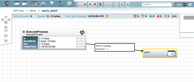

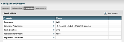

b) Drop an "ExecuteProcess" Processor to canvas [or you can use TailFile Processor] to read lines added to "nifi-app.log". Auto Terminate relationship Failure. The configuration on the processor would look like below:
c) Drop an OutputPort to the canvas and Name it 'spark', Once added, connect "ExecuteProcess" to the port for Success relationship. This simple flow will look like below:

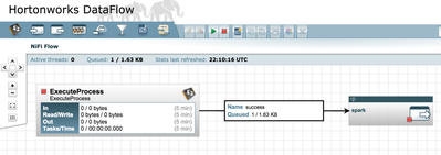

9) Lets Go back to the NiFi Web UI and start the flow we created, make sure nothing is wrong and you shall see data flowing

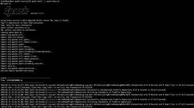

10) Now load the script to spark-shell with below command and start streaming:
# spark-shell -i spark-data.sh
11) In the screenshot below, you can see the NiFi logs being pulled and printed on the console:

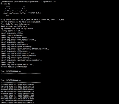

12) Same way we can pull data from NiFi and extract the associated Attributes:

13) In the screenshot below, you can see the FlowFile attribute "uuid" being extracted and printed on the console:

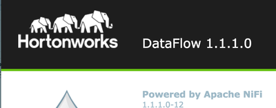

I am using DataFLow on HDP 2.3 which has Nifi 0.3.
2519-screen-shot-2016-03-02-at-10745-pm.pngAlso, do i need to use port 8055 for SiteToSiteClient in step 8 based nifi.remote.input.socket.port set in step 4?
I updated Nifi as you mentioned in step1. Now, its DataFlow 1.1.1.0 and Nifi 1.1.1.0-12. But, i am getting similar error for output port.
