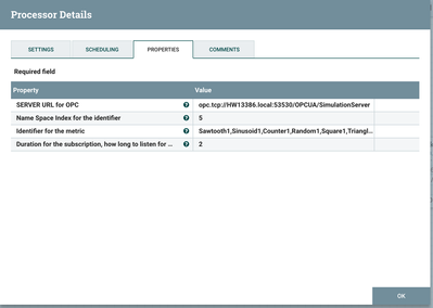

To allow nifi to connect and consume data from the OPC server, we will be using the eclipse Milo library, which communicates with the server over OPC UA. To make it easy and reproducable, i created a custom processor . The repository is located here. Simply clone the repo. build using mvn clean package -Dskiptests. Once the processor is built just copy the .nar file to nifi/lib folder. Restart Nifi. Developed a nifi flow using the opc processor to extract data from the opc server and publishkafka to push data to a kafka topic.
The consumeopc events processor was configured as below.
Once flow is configured and started, you should see data being to the kafka topic. Now we will configure the druid kafka ingestion spec. This let druid run real time jobs that will pull data from kafka topic into druid real time nodes for segmenting.

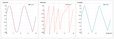

We will superset for the visualization. It may take upto a a few minutes to atleast an 1 hour for the druid datasource to be available based on your configration. Once it is available, click on Source > Refresh druid metadata to see the new iot_ds data source.
Upon creating a slice we can clearly see the different signals plotted on superset. I am using a 1 second granularity for these slices.
