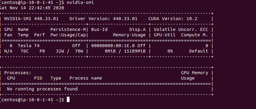

Before proceeding to enable GPU on YARN, check that your Nvidia drivers are installed correctly:
  1. Run nvidia-smi, it should list out the GPUs on your system. If nothing shows up, then your drivers were not properly installed. If this is showing nothing or erroring out, there are a few things to check.nvidia-smi.png

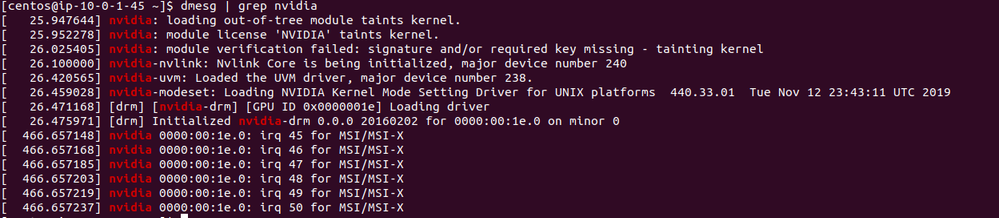

  2. Run dmesg | grep nvidia to see if Nvidia drivers are being started on boot:dmsg_nvidia.png

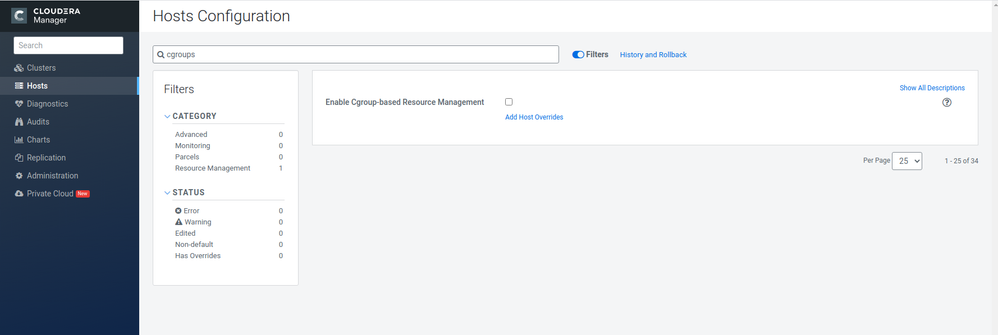

To schedule GPUs, we need GPU isolation and for that we need to leverage Linux Cgroups. Cgroups are Linux controls to help limit the hardware resources that different applications will have access to. This includes CPU, RAM, GPU, etc, and is the only way to truly guarantee the amount of resources allocated to a running application.
In Cloudera Manager, enabling Cgroups is a host-based setting that can be set from the Hosts >> Hosts Configuration option in the left side toolbar.
Search for Cgroups to find the tickbox.
Selecting the big tickbox will enable it for all nodes, but it can also be set on a host-by-host basis through the Add Host Overrides option. For more details on the finer details of the Cgroup settings, refer to CDP-PvC Base 7.1.4 cgroups documentation.

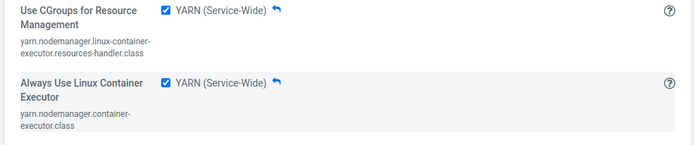

With Cgroups enabled, we now need to turn on Cgroup Scheduling under the YARN service.
  1. Go to the YARN service Cloudera Manager
  2. Go to Resource Management, and then search for cgroup
  3. Tick the setting Use CGroups for Resource Management

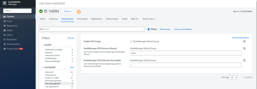

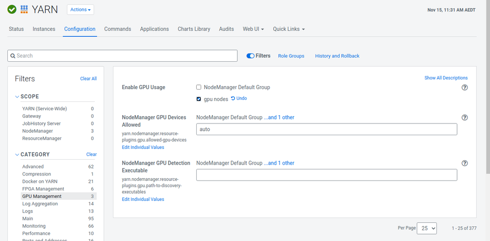

  5. Now we can enable GPU on YARN through the Enable GPU Usage tickbox. You can find that under Yarn >> Configuration then the GPU Management category.yarn_gpu_usage.png
Before you do that, however, it is worth noting that it will by default enable GPUs on all the nodes which means all your YARN Node Managers will have to have GPUs. If only some of your nodes have GPUs, read on!
YARN Role Groups
As discussed, Enable GPU Usage would enable it for the whole cluster. That means that all the Yarn nodes would have to have GPUs and for a large sized cluster that could get very expensive. There are two options if you have an expense limit on the company card.

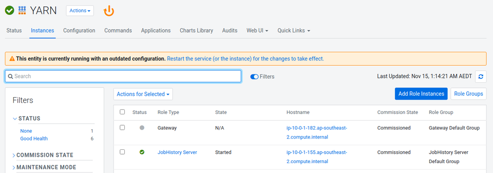

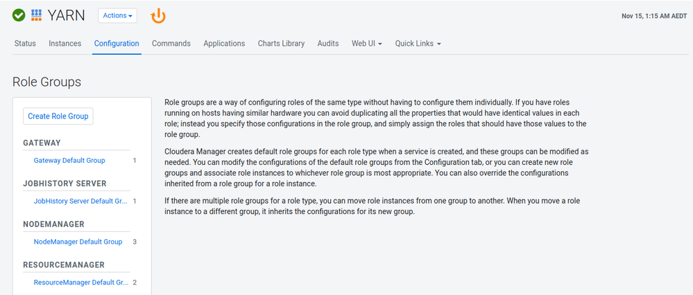

The other option is to stick with one cluster whilst adding a GPU or two is to create Role Groups. These allow for different Yarn configs on a host by host basis. So, some can have Enable GPU Usage turned on whilst others do not.
Role groups are configured on the service level. To setup a GPU role group for YARN, do the following:

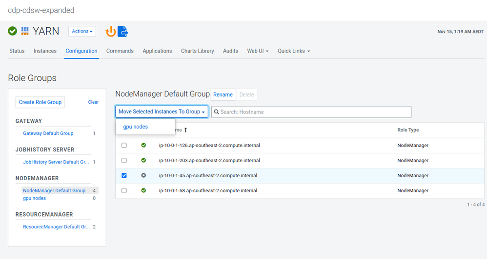

  1. In Cloudera Manager navigate to Yarn >> Instances. You will see the Role Groups button just above the table listing all the hosts.yarn_role_groups.png
  2. Click Create a role group. In my case, I entered the Group Name gpu nodes of the Role Type NodeManager and I set the Copy From field to NodeManager Default Group.yarn_create_role_groups.png
  3. With our role group created, it is time to assign the GPU hosts to the gpu nodes group. Select the nodes in the NodeManager Default Group that have GPUs and move them to the new GPU Node group.yarn_reassign_role_group.png
  4. With our role group created, we will be able to Enable GPU Usage just for the GPU nodes. For more details on role groups, refer to Configuring Role Groups . Note you may need to restart the cluster first.gpu_role_group.png

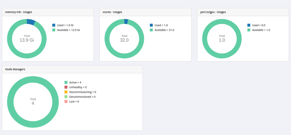

Now that we have everything set up, we should be able to see yarn.io/gpu listed as one of the usage meters on the Yarn2 cluster overview screen. If you do not see this dial, it means that something in the previous config has gone wrong.

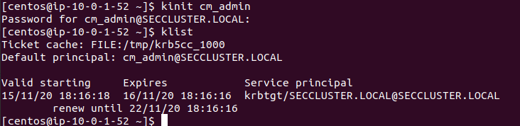

On a Kerberised cluster, you will need to firstly kinit as a valid kerberos user first for the following to work. You can use klist to verify that you have an active kerberos ticket.
