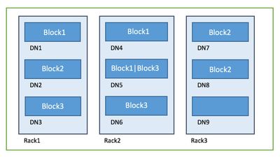

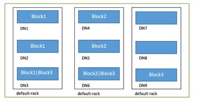

The following diagram depicts an example block placement when HDFS and Yarn are not rack aware:
  • What happens if Rack1 goes down? -> Potentially data in Block1 might be lost
    • Not being Rack aware the entire cluster is thought of placed in default-rack
The following diagram depicts an example block placement when HDFS and Yarn are rack aware:
  • What happens if Rack1 goes down? We still have the block replicas in other data nodes
So evidently Rack awareness increases data availability. Also the HDFS balancer and decommissioning of data nodes are rack aware operations.
