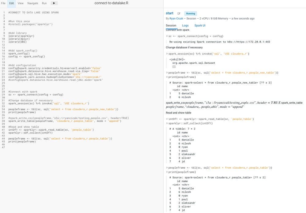

Notice that the first print table is showing the two rows, Danielle and Nilesh.  The second table print is showing the table people_table after we wrote the two new rows, where instead of five initial records, we show seven (since we appended).
  • I do print the same table twice - just showing two different ways to read from a table (I prefer the SQL option).

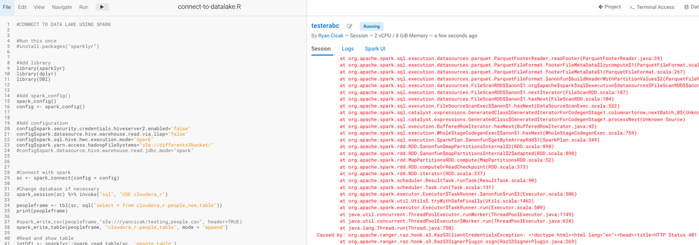

  • If you do not choose the correct bucket name (the S3 bucket where you're reading/writing tables) - you'll receive an error.  In my case, I receive a RAZ 401 error (since I have RAZ enabled).  If I change my bucket after running one in my session, I'll still get the error.  I need to stop and then start a new session to take in the correct bucket.
  • I can add multiple S3 locations separated with commas.
Notice that I changed my hadoopFileSystems to "differents3bucket" and receive the access error.  Even if I change back to "ryancicak", I still receive an access error until I start a new session.
