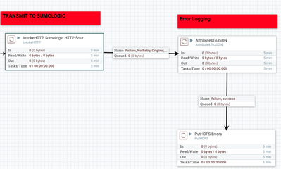

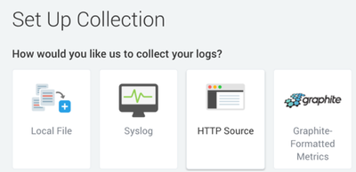

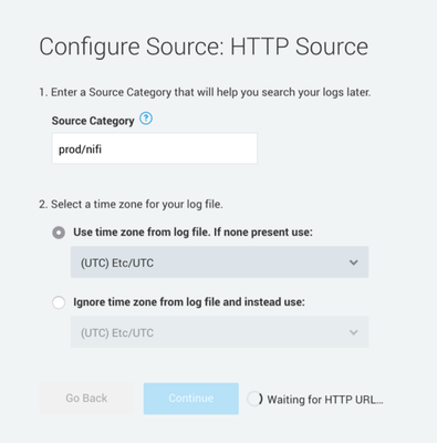

The integration point for sending log data to Sumologic is their HTTP Source. To send data you must setup an HTTP Source in Sumologic from your web console as shown below. Take the HTTP string they give to you and put into an InvokeHTTP processor with POST, it will look something like this: https://endpoint1.collection.us2.sumologic.com/receiver/v1/http/ZaLongCodeLong

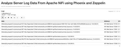

Finally displaying and charting data is up next, easy as pie in Zeppelin. Just query my Phoenix data.

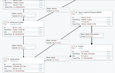

The flow is a bit long as I am using RegEx to convert the logs from NiFi Log4J format to individual attributes then make them into a JSON file and convert to SQL upsert for Phoenix insert. I log all failures to a file.

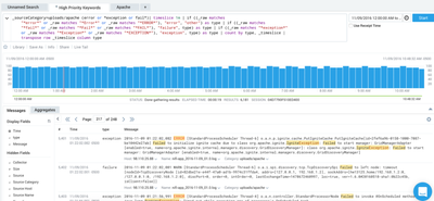

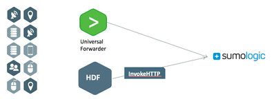

Transmitting Log Data
It's pretty easy to integrate with Sumologic. They have a nice HTTP endpoint to send this data. They will accept JSON and many other text formats. They have a native agent, which can be interfaced with as well via several logging mechanisms. I asked them about it and I may work on that in the future.
