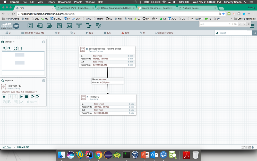

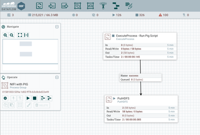

Pig to Apache NiFi 1.0.0

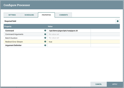

ExecuteProcess
We call a shell script that wraps the Pig script.
Output of script is stored to HDFS: hdfs dfs -ls /nifi-logs

PutHDFS
Hadoop Configuration: /etc/hadoop/conf/core-site.xml
Pick a directory and store away.
