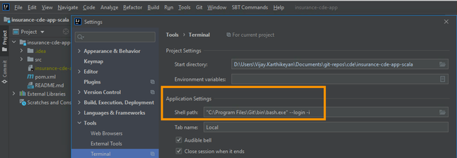

  2. In IntelliJ, go to File > Settings, modify the "shell path" to the following:
    C:\Program Files\Git\bin\bash.exe" --login -i

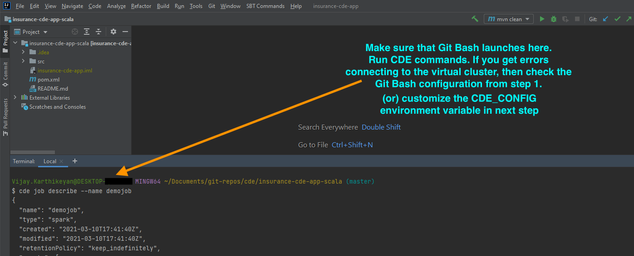

  3. Test this setting by launching a terminal from within the IntelliJ project and running CDE CLI commands. If you are unable to run CDE CLI commands (with environment variable CDE_CONFIG not configured), you will have the option to setup/override it in the next step.

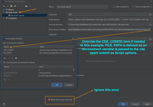

  4. Add a Run/Debug configuration with a new Shell script with the following details. Ignore the error stating that the Shell script is not found. You have the option of overriding the CDE_CONFIG environment variable (in case you want to submit it to a different cluster than the system default). Use environment variables to supply arguments to your Spark job:

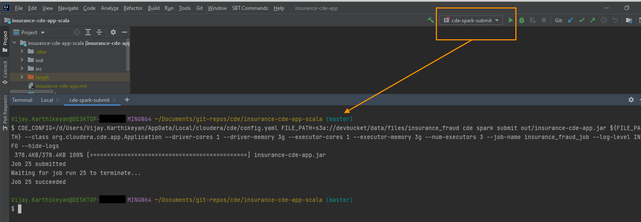

  5. Run the cde spark submit from the Run/Debug menu as shown as follows. You should see the job run in the terminal window in Intellij.
