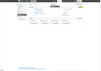

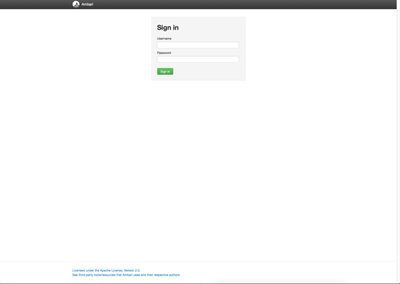

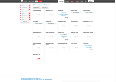

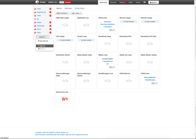

Check Ambari
The Ambari UI should be available at http://node1:8080. Ambari should present you with a login screen.
NOTE: The vagrant hostmanager plugin should automatically update the /etc/hosts file on your local machine to add a node1 entry
You should see something similar to this:
You should be able to log into the interface using admin as the username and password. You should see something similar to this:
You should notice that all of the services are red. They do not auto start. Click the Actions button and then the Start All link. You should see something similar to this:

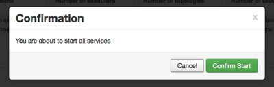

You should see a confirmation dialog similar to this:

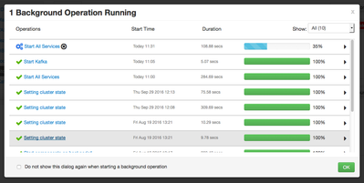

Click the green confirm button. You should see an operations dialog showing you the status of the start all process. You should see something similar to this:
Click the green OK button and wait for the processes to finish starting. Once the startup process is complete, you should see something similar to this:

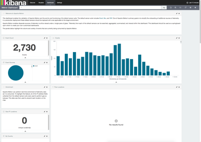

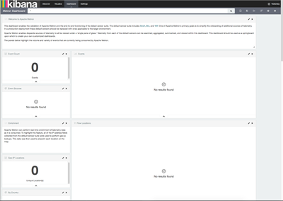

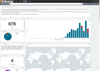

Check Kibana dashboard
Now that the cluster is running, we want to check our Kibana dashboard to see if there are any events. The Kibana dashboard should be available at http://node1:5000.
The dashboard should present you with both bro and snort events. It may take a few minutes before events show up. If there are no events, then you should see something similar to this:
If you see only one type of events, such as snort, then you should see something like this:
Seeing either versions of these dashboards after 5-10 minutes indicates there is a problem with the data flow.

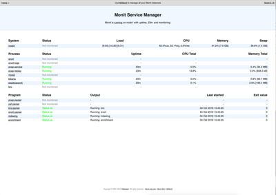

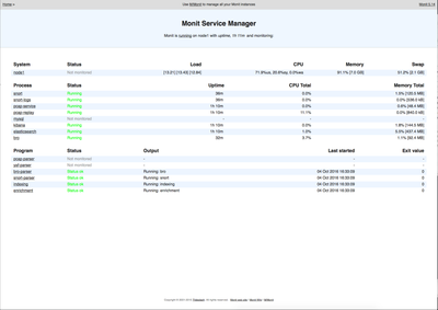

Check monit dashboard
The first thing you can do is check the monit dashboard. It should be available at 'http://node1:2812'. You should be presented with a login dialog. The username is admin and the password is monit. You should see something similar to this:
If you are unable to access the monit dashboard ui, try using the command-line. The monit command requires sudo.

If you see something like this:
$ sudo monit status
Cannot create socket to [node1]:2812 -- Connection refused
Then check to make sure that monit is running:
$ sudo service monit status
monit (pid  3981) is running...
If the service is running, but you can't access the web user interface or the command line, then you should restart the service.
$ sudo service monit restart
Shutting down monit:                                       [  OK  ]
Starting monit:                                            [  OK  ]

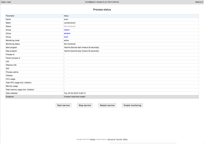

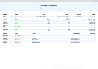

Now verify you can access the monit web ui. If you see any of the items under Process listed as Not Monitored, then we should start those processes.
Note: The vagrant image is using vagrant hostmanager to automatically update the the /etc/hosts file on both the host and the guest. If monit still does not restart properly, check the /etc/hosts file on node1. If you see:
127.0.0.1 node1 node1
on the first line of your /etc/hosts file, comment out or delete that line.

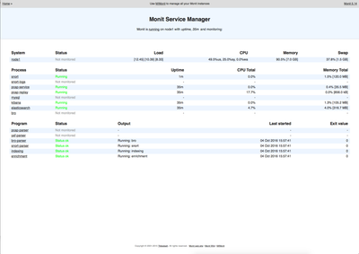

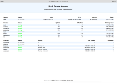

In my example, I can see that snort,snort-logs, bro processes are not running. I'm going to start them by clicking on the name of the process which will bring up a new view similar to this:
First click the Enable Monitoring button. The status should change to Not monitored - monitor pending. Click the Home link in the upper left of the monit dashboard. This takes you back to the main monit dashboard. You should see something similar to this:
Once the process has initialized, you should see something similar to this:
Repeat this process for the snort-logs and bro processes. Once that is complete, the monit dashboard should look similar to this:

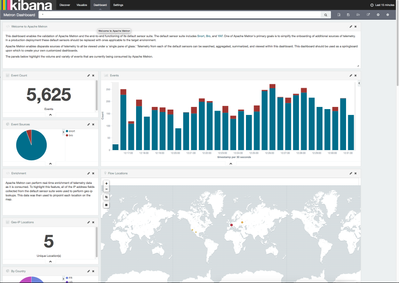

Recheck the Kibana dashboard
Now recheck the Kibana dashboard to see if there are new events. You should see something similar to this:
If you do not see this, then we need to continue troubleshooting.

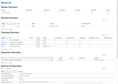

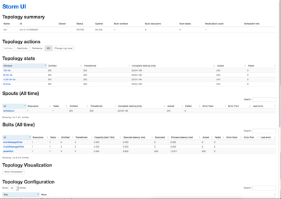

In the quick links section, click on the Storm UI link. You should see something similar to this:
Under the Topology Summary section, there should be at least 4 topology entries: bro, enrichment, indexing, and snort
Click on the bro link. You should see something similar to this:
You should see events in the Topology stats section under the Acked column. Under the Spouts and Bolts sections, you should see events under the Acked column for the kafkaSpout and parserBolt respectively.

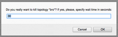

Under Topology actions, click on the kill button. This will kill the topology. The monit process should automatically restart the topology.
You should see a dialog asking you for a delay value in seconds, something similar to this:
The delay defaults to 30 seconds. You can set it to a smaller number, like 5. Then click the ok button.
Go back to the main Storm UI page. You should see something similar to this:
You should notice the bro topology is now missing. Now take a look at the monit dashboard. You should see something similar to this:
You may notice several programs listed as Status:failed. After a few seconds, monit will restart the topologies. You should see something similar to this:

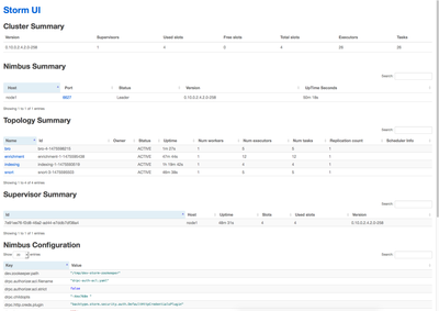

Now go back to the Storm UI. You should see something similar to this:
You should notice the bro topology is back and it has an uptime less than the other topologies.
You can repeat this process for each of the topologies.
Recheck Kibana dashboard
Now we can recheck our Kibana dashboard. You should see something similar to this:
Now you events running through the Metron stack.
