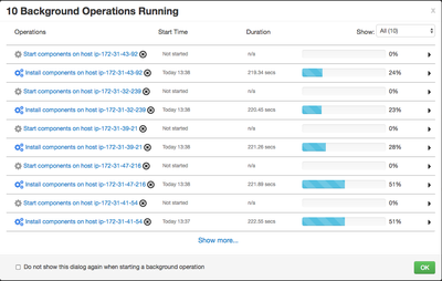

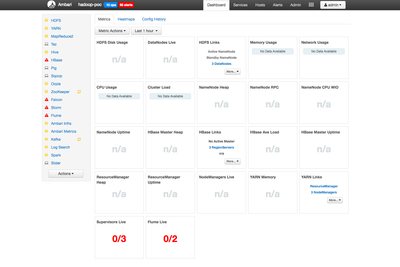

Click on the Operations icon that shows 10 operations in progress. You should see something similar to the following:
The installation task each takes between 400-600 seconds. The start task each take between 20-300 seconds. The master servers typically take longer to install and star than the slave servers.

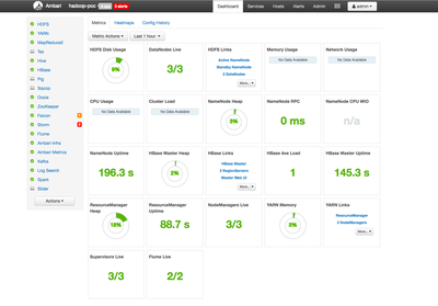

When everything is running properly, you should see something similar to this:
If you look back at your terminal window, you should see something similar to the following:
ok: [master03]
TASK [ambari-server : Fail if the cluster create task is in an error state] ****
skipping: [master03]
TASK [ambari-server : Change Ambari admin user password] ***********************
TASK [Cleanup the temporary files] *********************************************
changed: [master03] => (item=/tmp/cluster_blueprint)
changed: [master03] => (item=/tmp/cluster_template)
changed: [master03] => (item=/tmp/alert_targets)
ok: [master03] => (item=/tmp/hdprepo)
PLAY RECAP *********************************************************************
localhost                  : ok=5    changed=3    unreachable=0    failed=0
master01                   : ok=8    changed=0    unreachable=0    failed=0
master03                   : ok=30   changed=8    unreachable=0    failed=0
slave01                    : ok=8    changed=0    unreachable=0    failed=0
slave02                    : ok=8    changed=0    unreachable=0    failed=0
slave03                    : ok=8    changed=0    unreachable=0    failed=0
