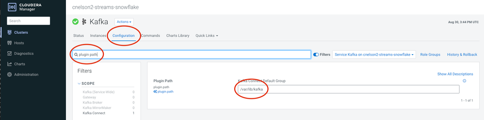

The default setup for a Streams Messaging data hub in CDP includes many Kafka Connect sources & sinks, but obviously every connector can't be included.  To use a 3rd party connector you need to download the jar(s) to each broker node in your Streams Messaging cluster.  Where exactly to put the jar files depends on what sort of jar it is.  If it is completely contained in one "fat" jar, then it can go into the plugin path defined in Cloudera Manager which is set to /var/lib/kafka by default.

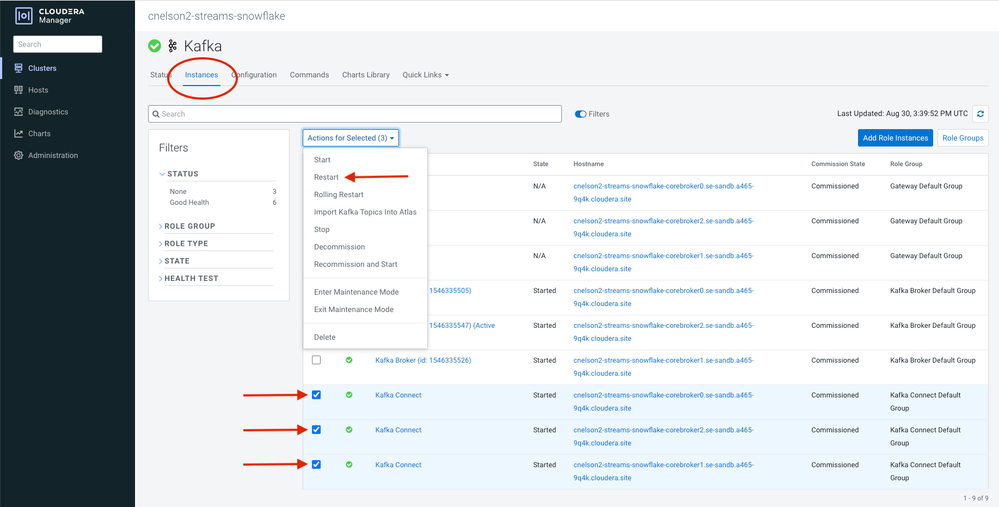

Once the jars are in place on every broker node, you'll need to restart the Kafka Connect roles from within Cloudera Manager:   Clusters --> Kafka, and then find the Kafka Connect roles under the Instances tab.  Check all of them and click Restart.

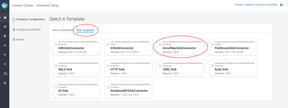

Once the roles have restarted, open up the Kafka Connect UI within Streams Messaging Manager, start a New Connection, and navigate to the Sink Templates tab. You should now see a SnowflakeSinkConnector, ready for you to sink data through. So let's put it to work.
If you don't see the SnowflakeSinkConnector here, verify that the jars are on all your broker nodes and that the permissions are correct.   And that Kafka has been restarted across the entire cluster.

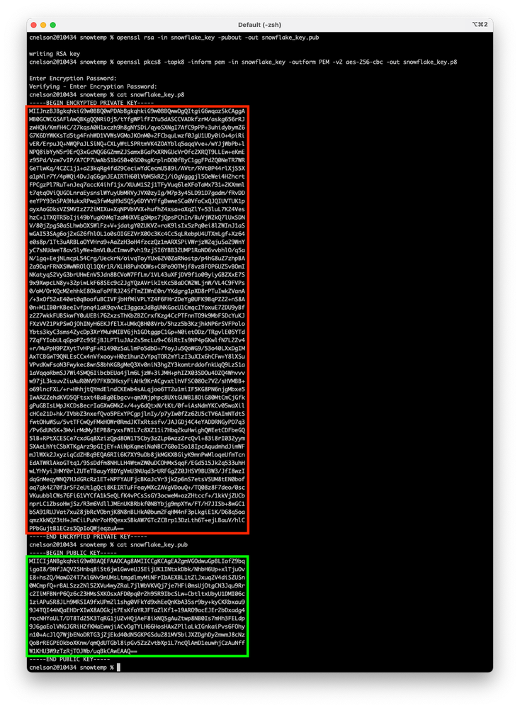

From your local machine, run these steps to create the public & private keys:
openssl genrsa -out snowflake_key.pem 2048
openssl rsa -in snowflake_key.pem -pubout -out snowflake_key.pub
If you need to instead use an encrypted private key, use these steps:
openssl genrsa -out snowflake_key 4096
openssl rsa -in snowflake_key -pubout -out snowflake_key.pub
openssl pkcs8 -topk8 -inform pem -in snowflake_key -outform PEM -v2 aes-256-cbc -out snowflake_key.p8
It will ask you for a passphrase which you can set to whatever you like. You'll use this when you configure the connector.

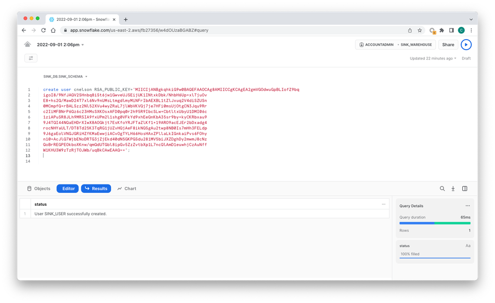

You'll need the public key to create your user within Snowflake, so cat the contents of snowflake_key.pub and copy everything between the "-----BEGIN PUBLIC KEY-----" and "-----END PUBLIC KEY-----".  Use that public key when creating your user as shown below. Be sure to remove all the line feeds, so that your public key is a single line of text (it's ok if the Snowflake UI wraps the line).

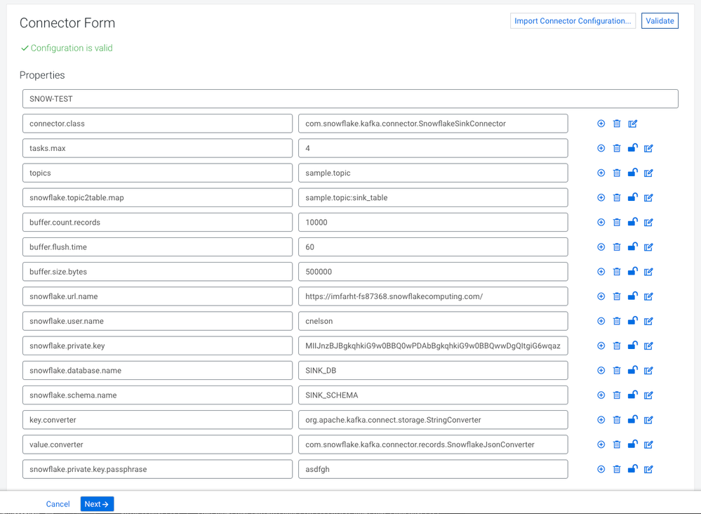

Configuring the Snowflake connector is fairly straightforward, but you may want to import this configuration boilerplate which will get you 85% of the way there.
	"connector.class": "com.snowflake.kafka.connector.SnowflakeSinkConnector",
	"tasks.max": "4",
	"topics": "sample.topic",
	"snowflake.topic2table.map": "sample.topic:sink_table",
	"buffer.count.records": "10000",
	"buffer.flush.time": "60",
	"buffer.size.bytes": "500000",
	"snowflake.url.name": "",
	"snowflake.user.name": "",
	"snowflake.private.key": "",
	"snowflake.database.name": "SINK_DB",
	"snowflake.schema.name": "SINK_SCHEMA",
	"key.converter": "org.apache.kafka.connect.storage.StringConverter",
	"value.converter": "com.snowflake.kafka.connector.records.SnowflakeJsonConverter"
If you used an encrypted private key when you created your public/private keys you will also need to add this configuration item with the passphrase you used.  You can either carefully add it to the json before you import, or use the (+) button to add the property after import.
	"snowflake.private.key.passphrase": ""
That leaves three configuration items that need to be completed.
  • snowflake.user.name:  this is the name of the user you created earlier.
  • snowflake.private.key:  this will be the contents of the pem or p8 private key file you created earlier.  Only the content between the BEGIN/END tags is needed.   Just paste that whole hot mess into the field.

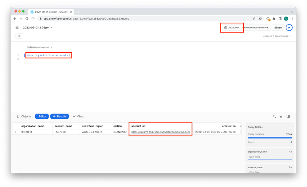

  • snowflake.url.name:  From Snowflake, change your role to ORGADMIN and run SHOW ORGANIZATION ACCOUNTS;  This will return an account_url which is what you'll use here.
Once the configuration is complete, click on the Validate button and hope for the best. Individual field errors will show inline, but jar related errors will be shown above the configuration section.  If you see no classdef found type errors, check that you have the Snowflake connector on every broker node, in the correct path, with 644 permissions. If you get a bouncy castle related error, check that you have the two encryption related jars (and the snowflake fat jar) in a subfolder under /var/lib/kafka, and that the directory permissions are 755. And that you restarted the Kafka Connect roles after you made those changes.  Once the configuration is valid, deploy the connector. And then watch nothing happen because we don't have any data flowing yet.
Click Next, and then deploy your connector.

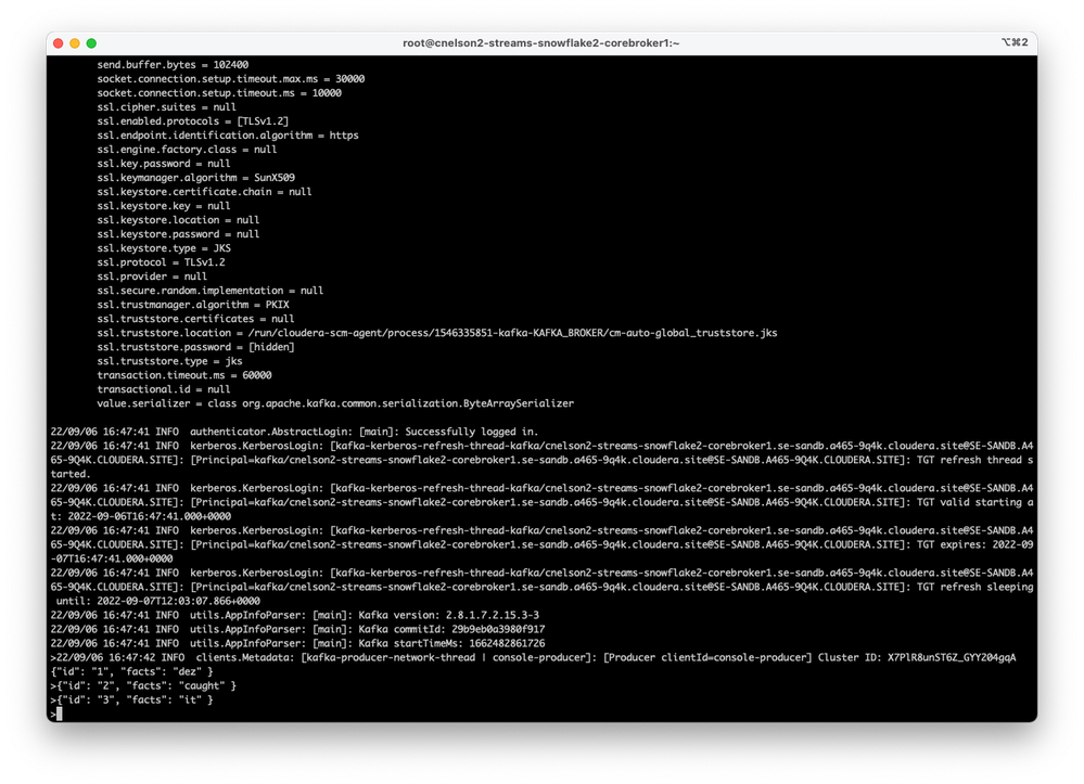

The easiest way (probably) to test the connector is by using the kafka-console-producer via ssh'ing into one of the broker nodes. And yes, I completely hand-waved over the complications of configuring the SSL properties for the console producer. For info on how to set that up, see this article (https://community.cloudera.com/t5/Community-Articles/Configuring-Kafka-Console-Producer-Consumer-on-...)
The console producer only requires minimal information to produce messages, primarily consisting of the brokers and the topic to which you want to publish.   The producer.config file handles the ssl configuration and is detailed here.  The topic we're using is the same topic we listed in the connect configuration parameter topics and also the snowflake.topic2table.map.
kafka-console-producer --broker-list cnelson2-streams-snowflake-corebroker0.se-sandb.a465-9q4k.cloudera.site:9093,cnelson2-streams-snowflake-corebroker1.se-sandb.a465-9q4k.cloudera.site:9093,cnelson2-streams-snowflake-corebroker2.se-sandb.a465-9q4k.cloudera.site:9093 \
--topic sample.topic \
--producer.config kafka-ssl.config
Once it gets rolling, it quietly waits for user input to publish to the topic, which our KConnect Snowflake sink connector will then consume those messages and send them to our Snowflake table.   Let's see it in action.
 Messages are produced....

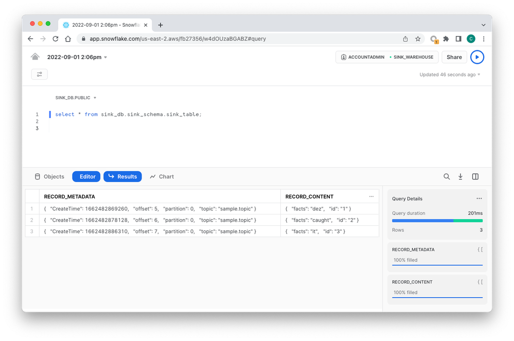

And eventually you can see them in Snowflake.  Note that the records will show up in your Snowflake table in "near real time," which in the real world means within a minute or so, but probably depends on a number of factors.
