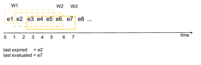

Sliding Window
In a sliding window tuples are grouped in windows and window slides every sliding interval. For example, a time duration based sliding window of length 10 secs and sliding interval of 5 seconds is evaluated every 5 seconds.
Here the first window (w1) contains the events that arrived up to the 10th second and the second window (w2) contains the events that arrived between 5th and 15th second. Also note that events e3 - e6 are part of both windows. When window w2 is evaluated at time t = 15 secs, the events e1 and e2 are expired (dropped out of the event queue).

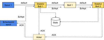

Checkpoint mechanism
Checkpoint is triggered by an internal checkpoint spout at the specified topology.state.checkpoint.interval.ms. If there is at least one IStatefulBolt in the topology, the checkpoint spout is automatically added by the topology builder . For stateful topologies, the topology builder wraps the IStatefulBolt in a StatefulBoltExecutor which handles the state commits on receiving the checkpoint tuples. The non stateful bolts are wrapped in a CheckpointTupleForwarder which just forwards the checkpoint tuples so that the checkpoint tuples can flow through the topology DAG. The checkpoint tuples flow through a separate internal stream namely $checkpoint. The topology builder wires the checkpoint stream across the whole topology with the checkpoint spout at the root.
At checkpoint intervals the checkpoint tuples are emitted by the checkpoint spout. On receiving a checkpoint tuple, the state of the bolt is saved and then the checkpoint tuple is forwarded to the next component. Each bolt waits for the checkpoint to arrive on all its input streams before it saves its state so that the state represents a consistent state across the topology. Once the checkpoint spout receives ACK from all the bolts, the state commit is complete and the transaction is recorded as committed by the checkpoint spout.
The checkpoint mechanism builds on top of storm's existing acking mechanism to replay the tuples and uses concepts from the asynchronous snapshot algorithm used by flink and the Chandy-Lamport algorithm for distributed snapshots.The checkpointing internally uses a three phase commit protocol with a prepare and commit phase so that the state across the topology is saved in a consistent and atomic manner.

State provider
The framework instantiates the state via the corresponding StateProvider implementation. A custom state should also provide a StateProvider implementation which can load and return the state based on the namespace. Each state belongs to a unique namespace. The namespace is typically unique per task so that each task can have its own state. The StateProvider and the corresponding State implementation should be available in the class path of Storm (by placing them in the extlib directory).
Stateful windowing
The windowing implementation in storm core acknowledges the tuples in the window only when they fall out of the window. For example consider a window configuration with window length 5 mins and sliding interval 1 min. The tuples that arrived between 0 - 1 min are acked only when the window slides past 1 min i.e at the 6th minute.
If the system crashes tuples e1 to e8 gets replayed (assuming ack for e1 and e2 did not reach the acker) and w1, w2 and w3 will get re-evaluated. Stateful windowing tries to minimize the duplicate window evaluations by saving the last evaluated and last expired state of the window. Stateful windowing expects a monotonically increasing message id to be part of the tuple and uses the stateful abstractions discussed above to save the last expired and last evaluated message ids in the state. During recovery the last expired and last evaluated message ids are used to avoid duplicate window evaluations. Tuples with message id lower than last expired id are discarded and tuples with message id between the last expired and last evaluated message ids are fed into the system without activating any triggers. The tuples beyond the last evaluated message ids are processed as usual.
State support in windowing is provided by IStatefulWindowedBolt. User bolts should typically extend BaseStatefulWindowedBolt for doing windowing operation with the framework automatically managing the state of the window.
Example Topology
An example topology in storm starter StatefulWindowingTopology demonstrates the usage of IStatefulWindowedBolt to save the state of the windowing operation to avoid re-computation in case of failures. The framework internally manages the window boundaries and does not invoke execute(TupleWindow inputWindow) for the already evaluated windows in case of restarts during failures.
