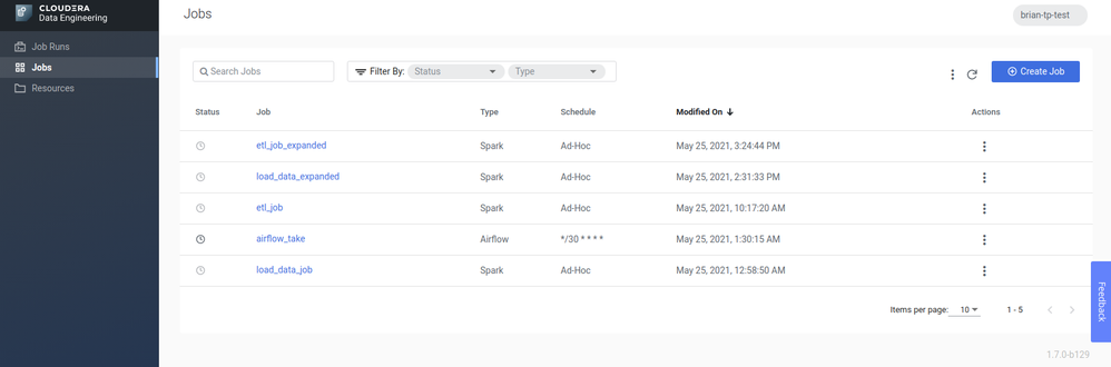

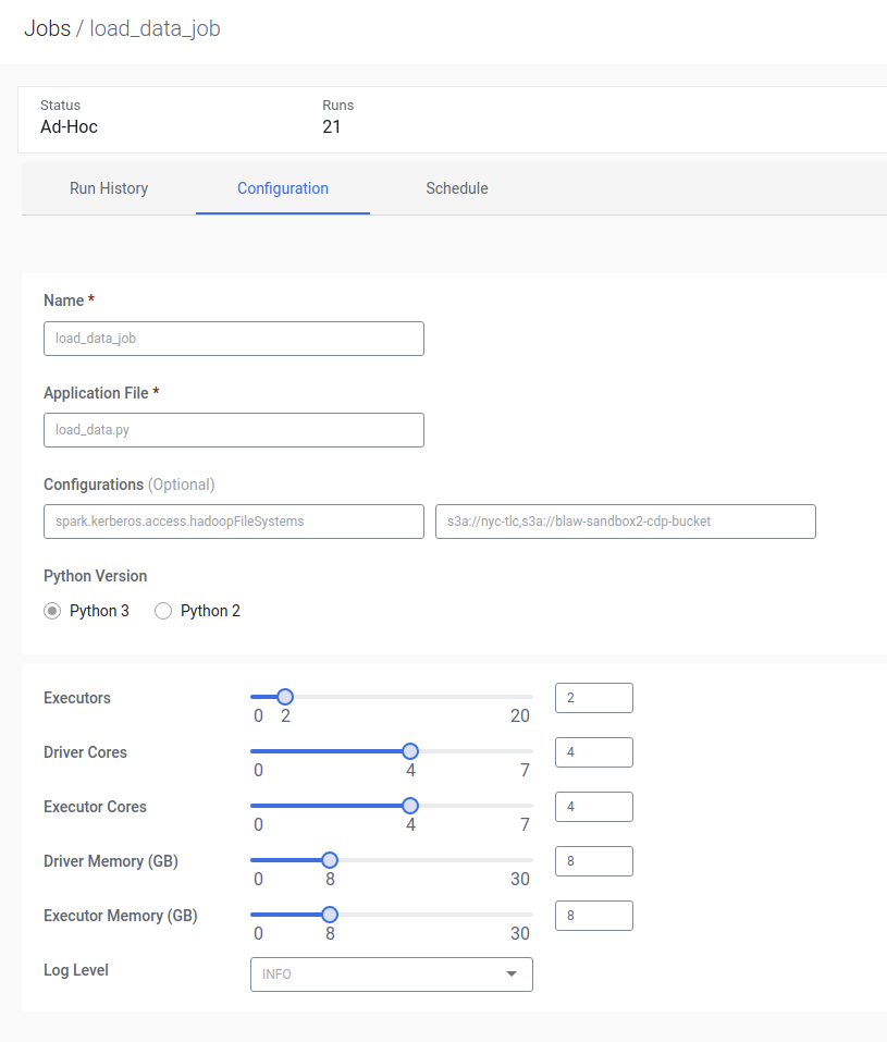

For deploying the `load_data` script, we can simply define it as a new job in the CDE UI.
For this particular example, we set up the load_data script used the following settings:

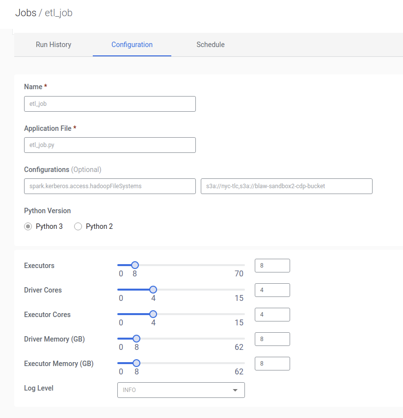

For the etl_job` script, we set it up like below:

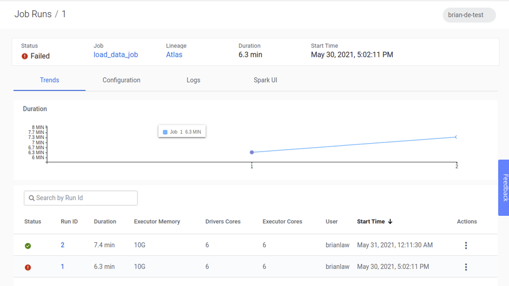

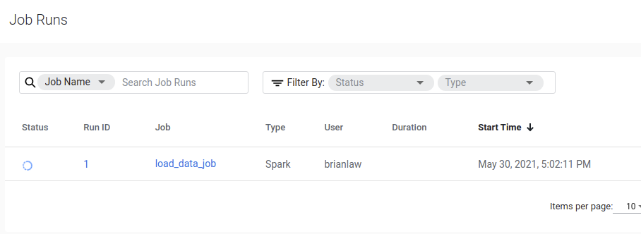

Once they are running, we can see it appear under jobs runs:

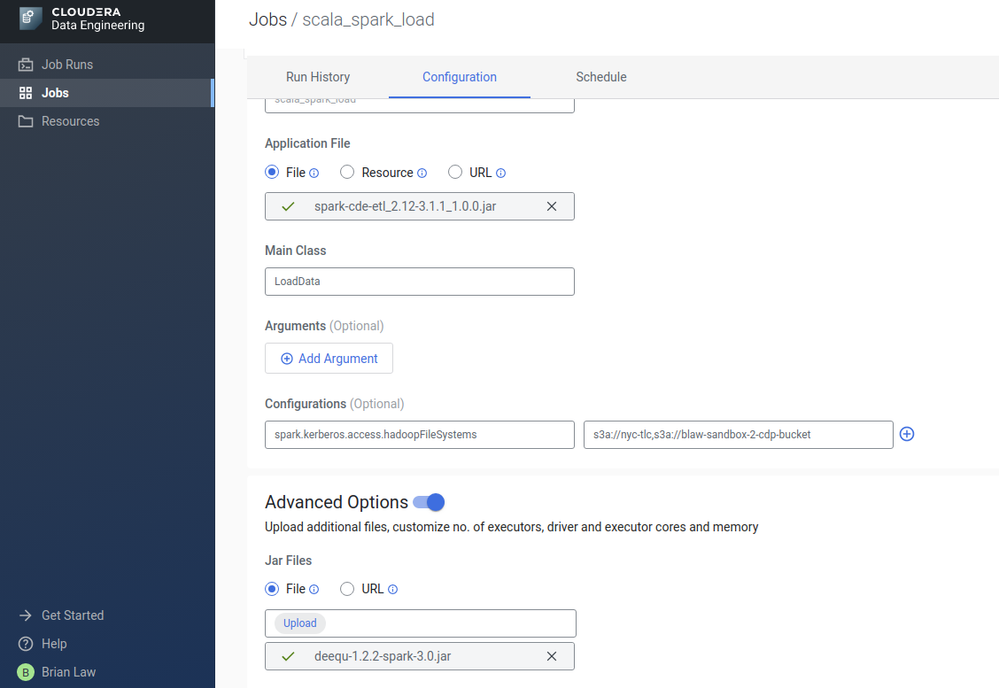

For small Spark jobs, CDE does support uploading a script directly through the CLI and the system will compile it on the fly. To execute your job in this manner, run:
cde spark submit <scala_job>.scala --job-name <your_job_name>

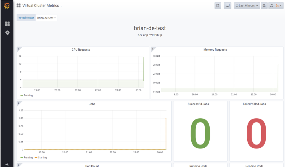

Understanding capacity issues

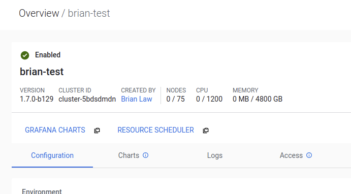

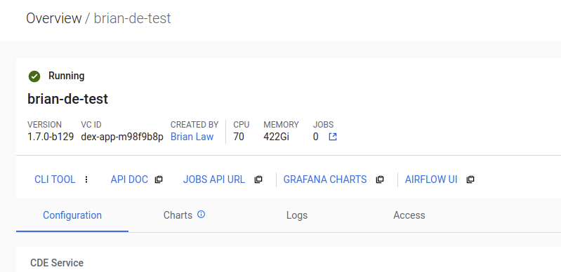

A common issue is running out of capacity. Remember we set this on two levels. A hard cap on the number of nodes allowed at the Service level and also a hard cap on the resources for a specific virtual cluster too.
Above we can see the Menu screen for the CDE service. Note that we can see that current 0/75 nodes are active with 0/1200 CPUs being used and 0/4800 GB memory being used. We can monitor the status of the cluster with the Grafana charts and also the Resource Scheduler buttons.

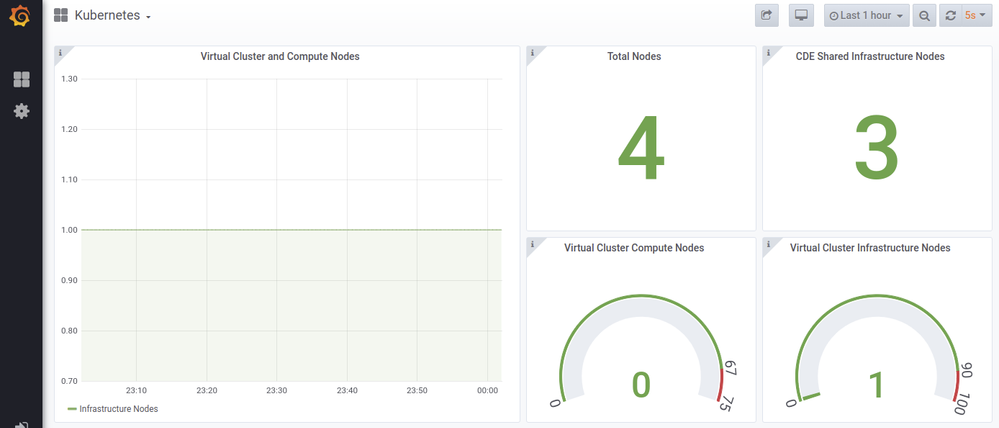

The Grafana Charts show the status of the cluster and a general number of jobs running.

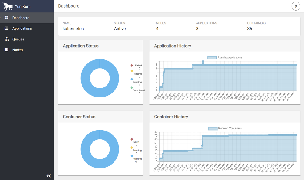

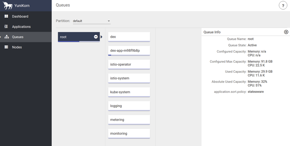

To understand a bit more about what our cluster is up tom we need to check the Resource Scheduler as well. Clicking on that tab will take us to:
Under the Queue tab in the Yunikorn menu, we can see the current status of the queues in the system. Now, this is the first confusing bit. Why is the queue showing so little memory and why is CPU 51% utilized? This is because Yunikorn only knows about the nodes that are currently active and not how many we can potentially spin up. As jobs run and the cluster scales, we will see this number increasing
On the Virtual Cluster level, we have this cluster overview. Unfortunately, we cannot see why many of the 70 CPU and 422Gi of memory is consumed.
But, we can go into the Grafana screen for the virtual cluster and see how many resources we are using and also potentially requesting.
Through the analysis of those screens, we can understand the state of resource consumption in the CDE Service. Issues with jobs starting will commonly be due to issues at this level. With either the YuniKorn scheduler being unable to schedule jobs, or the cluster autoscaler not being able to add nodes. It is worth pointing out at this juncture that for AWS at least there can be limits on the numbers of certain instances that an account can spin up. In heavy environments, it can be easy to hit those caps.

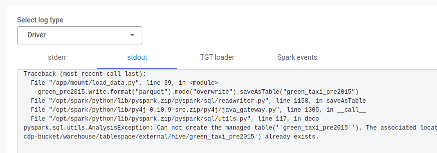

So, our job started fine, but it failed to complete successfully. In this case, we will have to look into the job run itself. Here is an example of a failed job:
The first place to check is the logs:
As we can see above, there are the `stderr` logs these are from the OS tier. The `stdout` logs are the errors from Spark itself.
In this case, we can see that the job failed as the director that the job was trying to write to already existed. Once we correct that, the job will run fine as we can see from the successful second run above.
