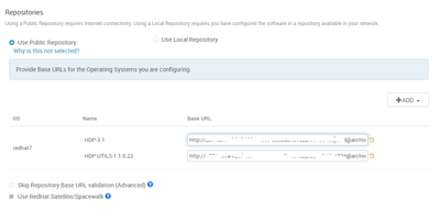

My repository base urls are as follows

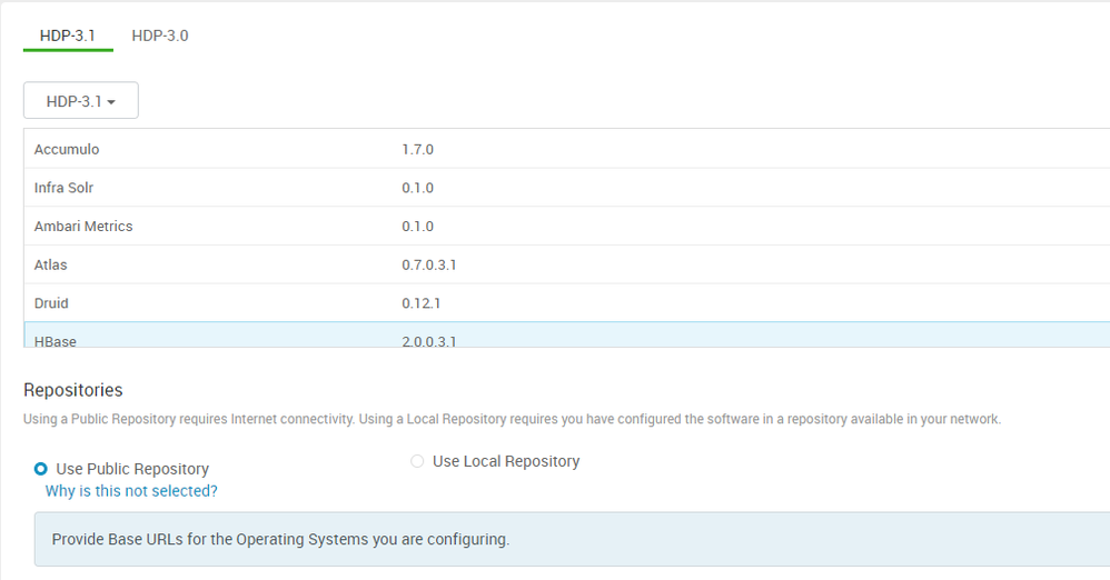

I am using the same above urls in Select Version step of installaton wizard and checked on Public Repository as below
I follow the same steps and all the servers are registered, chose the required services and then deployed.

Command failed after 1 triesWhen I looked at the ambari-hdp-repo in all servers, I noticed tht the base url for HDP and HDP Utils is blank.
[HDP-3.1-repo-3]
name=HDP-3.1-repo-3
baseurl=
path=/
enabled=1
gpgcheck=0
[HDP-UTILS-1.1.0.22-repo-3]
name=HDP-UTILS-1.1.0.22-repo-3
baseurl=
path=/
enabled=1
gpgcheck=0
As Far as internet connectivity to the base urls go, I am able to open the urls in browser and also in CLI using wget with the username authentication.
I have failed many times to understand the origin of these errors and request your intervention in resolving this issue. Have been stuck in this step for a month. Kindly help to resolve this matter and I would greatly appreciate it.
Awaiting your response keenly
Thanks
Created 07-26-2021 12:01 AM
@SSRIL Can you keep only one OS repository link and remove other OS properties from the Repository page
Also can check the repo under /etc/yum.repos.d/
Created 07-27-2021 10:36 PM
The issue has been resolved.
Summarising the resolution as below so that it helps others,
As suspected, the hdp repository was not completely configured.
So we deleted all the hdp repos from the servers.
Created a new hdp repo in ambari-server host with the respective urls along with username and password for HDP and HDP-UTILS.
Yum clean all, and yum repolist
Then started with the ambari server installation as mentioned in the official documentation.
Faced issues while installing hive especially with the mysql-connector-jar whose file size was around 24MB. Thanks for your help in providing the correct jar for the installation.
The official documentation is very helpful for beginners like us.
Now all the services are up and running successfully.
Again Thank you and your team for your help in resolving this issue.
Created 07-23-2021 12:41 AM
@SSRIL From the stack trace I can see, it is failing to install Smartsense hst package, Smartsense hst package is shipped with ambari reporitory
Make sure that ambari repository exists on the host
For the HDP repo, can you share a complete screenshot of the repositories page
Created 07-23-2021 04:24 AM
Thank you for your response.
ambari-repo does exist in the host, since ambari server was installed using the ambari-repo into consideration. Smartsense is included, but somehow it is not able to download it, which is my concern.
The hdp repo from the screenshot is as follows
I have commented out the username and password for security purposes. It is similar as follows:
HDP: http://LOGIN:PASSWORD@archive.cloudera.com/p/HDP/3.x/3.1.0.0/centos7
HDPUTILS: http://LOGIN:PASSWORD@archive.cloudera.com/p/HDP-UTILS/1.1.0.22/repos/centos7/
The above url with username and password I am able to access from browser and CLI both, however in the hdp.repo file all the baseurls are blank.
Created 07-26-2021 12:35 AM
yum repolist gave me the following repos
IDCRHEL7 REHL7 31,656
IDCRHEL7OPT RHEL7OPT 22,379
IDCRHEL7XTRA RHEL7XTRA 1,378
ambari-2.7.3.0 ambari Version - ambari-2.7.3.0 13
nodesource/x86_64 Node.js Packages for Enterprise Linux 7 - x86_64 52
yarn Yarn Repository 51
and these are the repos that are there in etc/yum.repos.d. Not sure which one to delete
ambari.repo
elasticsearch.repo
mas1.repo
nodesource-el7.repo
redhat.repo
yarn.repo
