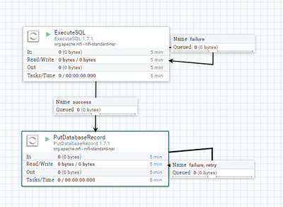

ExecuteSQL: SELECT * FROM IC_STAGE.TEMP_NIFI_1

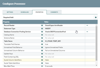

PutDatabaseSQL Properties:
  • Record Reader: Avro Reader

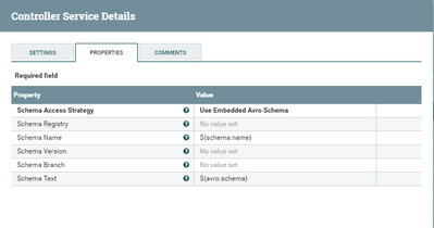

    • Schema Access Strategy: Use Embedded Avro Schema
My schema, when i view the details of the queue looks like this:
{"type":"record","name":"NiFi_ExecuteSQL_Record","namespace":"any.data","fields":[{"name":"ID_DATE","type":["null","string"]},{"name":"REC","type":["null",{"type":"bytes","logicalType":"decimal","precision":10,"scale":0}]}]}
I got the same error even when I used "Schema Text" as my access strategy.

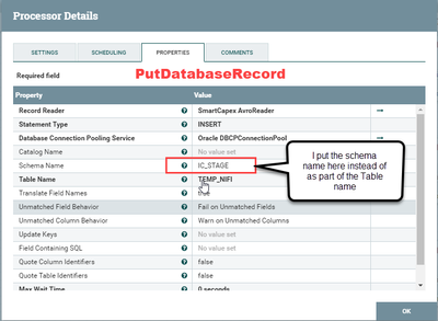

I found the solution today. I modified my PutDatabaseRecord processor. I explicitly put the Oracle Schema table instead of putting it part of the Table Name.
I am now using only 2 processors, ExecuteSQL and PutDatabaseRecord. No need for the AvroSplit processor.
