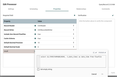

You can pass the input to the QueryRecord Processor with the following config:
The query above is added as a dynamic property which will expose new relationship with the property name that you can use to get the desired output. The query syntax is the following:
select id,TIMESTAMPADD(HOUR, -3,date_time) as date_time from flowfile

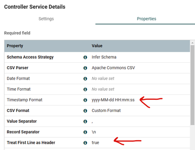

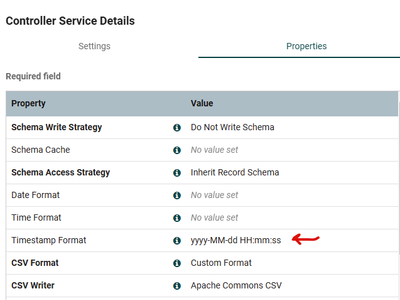

The trick for this to work is how you configure the CSV Reader and Writer to set the expectation on how to parse datetime fields in the reader\writer services:
For the CSVReader, Make sure to set the following:
CSVRecordSetWriter:
Output through Result relationship:
id,date_time
1234,2024-11-24 16:43:17
5678,2024-11-23 22:10:10
